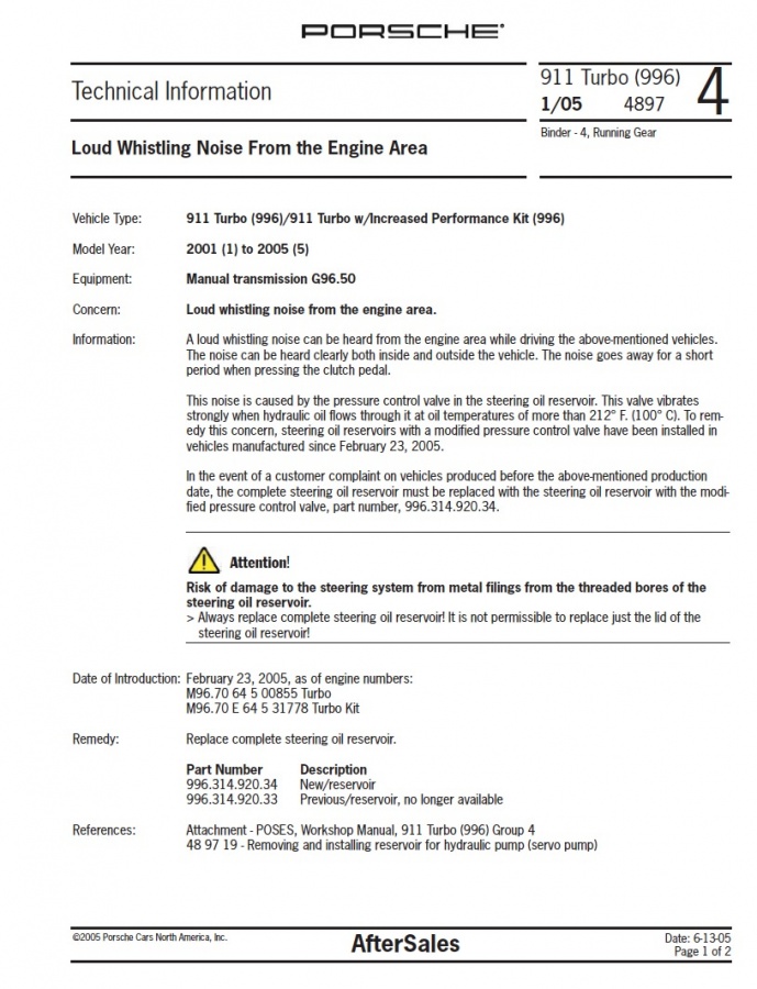

TSB 4897 see pics.... Be sure it comes from the power steering reservoir area. If it is you need to install an improve steering pump reservoir....

The power steering reservoir has a valve that can make that sound. The reason that it goes away when you step on the clutch is that the clutch and PS reservoir share the pentosin (via that valve).
To get rid of the whine you can replace the ps reservoir with a newer version that doesn't have that problem or go with the GT2 clutch slave conversion which separates the PS from the clutch mechanism.
I bought a brand new PS reservoir but before I got to install it my accumulator failed. I decided to go with the GT2 clutch slave conversion and still have the new reservoir sitting on a shelf in the garage. Not a single whine 1.5 years later.

It is a TSB, it is NOT a 'recall'. Just because PCNA publishes a fix does not mean they will cover the cost.
Pressure control valve on the PS reservoir.... and you need to get this fixed, the fluid is highly flammable.

i had the same issue and due to my habitual reading of the forum I went in with the tsb# for the steering reservoir and they replaced it no ?'s asked with about a week left under warranty. Of course by then they knew me pretty well and I'd bought the tech & s/a "lunch". A lot!
