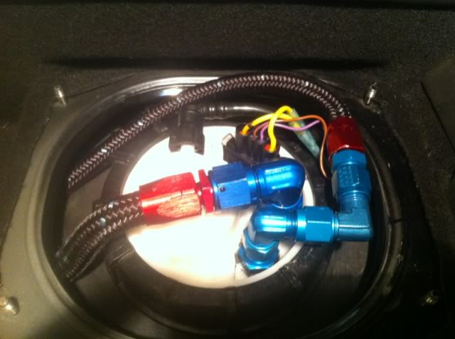

Originally Posted by atisvt99
Paging dgreen78... he's got a dual 044 pump setup on his car that I believe has left him with LOTS of headroom.
I went with a dual in-tank after having problems with my secondary inline pump. What I did was design a bracket made out of delrin to hold the 044 pumps in tank replacing the stock basket. The pumps are fed using the factory pick up lines that go to the back of the tank. Lines are -8 feed and -6 return. I am in the works of installing a cooler on the return line as the factory cooler was bypassed. If you run dual in-tank pumps you must have a cooler of some sort to prevent overheating the tank and also to keep the pumps happy, and quiet! My layout is very similar to Evoms setup but with a few improvements and it didnt cost me an arm and a leg
I looked at all different setups and felt this was the way to go. I was not about to install a huge LOUD single pump as this is my DD. I also looked at the dual pumps in the trunk using a sump method but didnt think having external lines outside the tank right behind my front bumper was a good idea on the street.

Dgreen,
Please don't take this the wrong way and I realize my post will be easy to dismiss since I am new here and you don't know me or my experience from Adam.
I have a pretty extensive background in building race cars and have done a lot of development in fuel supply systems for very demanding off road race applications.
In your plumbing pics you have a few 90* fittings that are of the sharp bend design. Those are know to cause cavatation in that application. Simply put. Cavaatation kills pumps. An easy fix is to swap the fittings to the sweeping radius design. I have diagnosed several systems failures due to cavatation attributed to the type of fitting you are using.
Camo

Originally Posted by Camo_cab
Dgreen,
Camo
I do not use the threaded and drilled fitting also, do to the same reason you point out.
