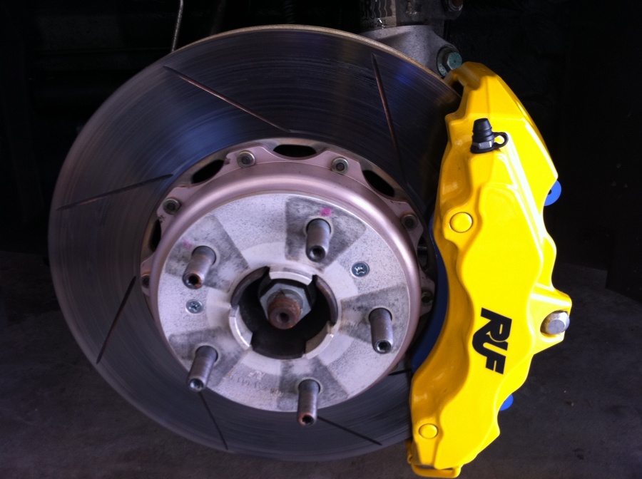

The RUF 7mm spacer I use is the only spacer I know of that has a hub centric lip on it. Even though you have a small amount of the hub sticking through the 7mm spacer its nice to have the larger lip.

H&R and RSS are hub centric for all spacers 7mm and larger.

False. 15mm and higher have hub centric lip but not 7mm spacer. Only RUF 7mm spacer has a hub centric lip.

My bad I guess. I could have sworn that RSS's 7mm spacer was hub centric. I'm getting old. I have their 15mm on OEM and they are of course. They are really well made. I probably would not want to use a spacer that wasn't hub centric.
