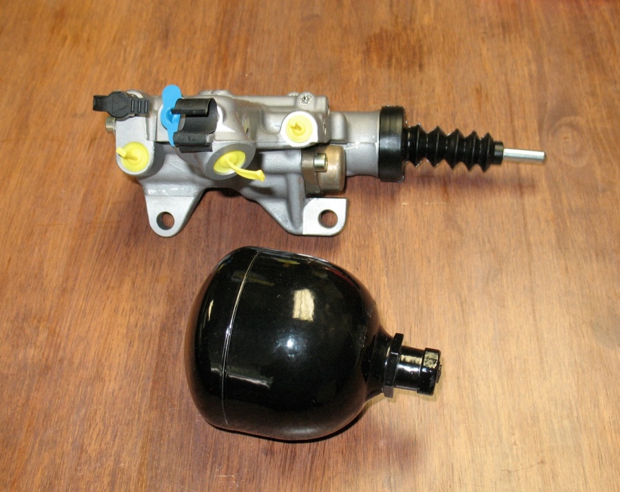

Good job! Your car being under warranty, they will have to replace the slave and normally they are not going to replace the accumulator. But the accumulator part# 997-314-166-00 (updated) is only about $146.00 and it is located on the slave part# 996 116 237 52. It is a good preventive maintenance to get it replaced at the same time. Picture show the slave on top and the accumulator in black.
