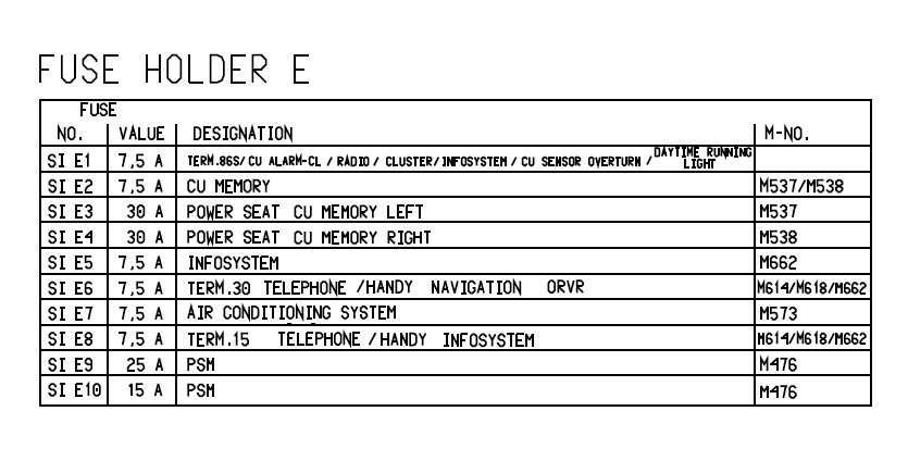

Take a look at fuse E3. Note: MY is always useful....
