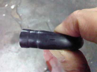

After went back to the Porsche dealer for the remote replacement, 1 min way from it and rev not able to go up 1000rpm, and keeps engine off, start it up and idle not longer keep up, tow to garage finally..
Checked and took out the fuel pump, using external electric to test on it, it works, but it is not able to pump the fuel up, so is that mean its time to replace or I could have something else to repair\rebuild it? Thanks in advance.
What a day to me, 3 weeks ownership and the first tow...

Fixed...........and this is the issue, a small tube on the fuel pump, seems to be a common issue on its failure.

ethanol reeks havoc on rubber.
