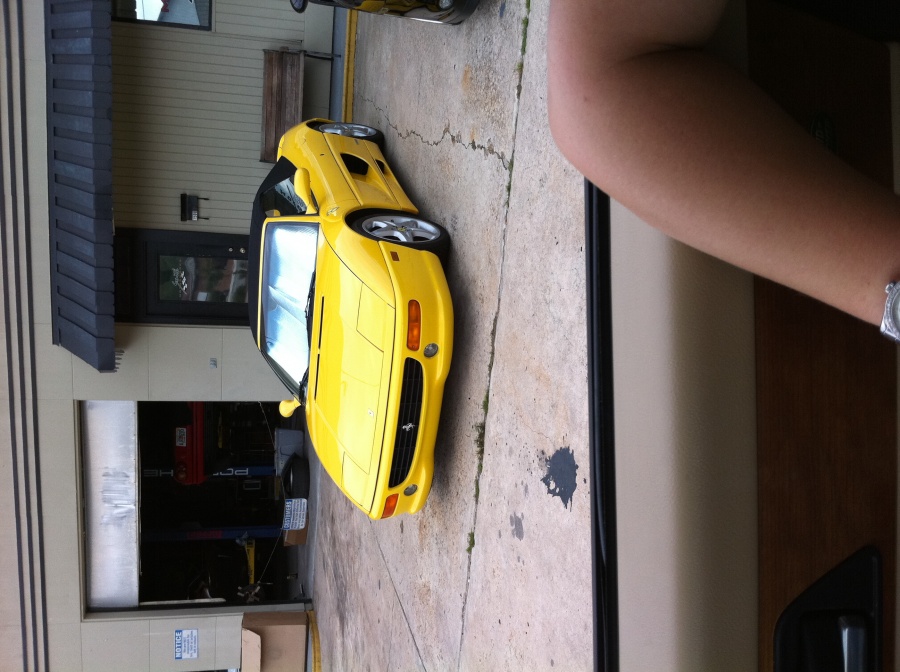

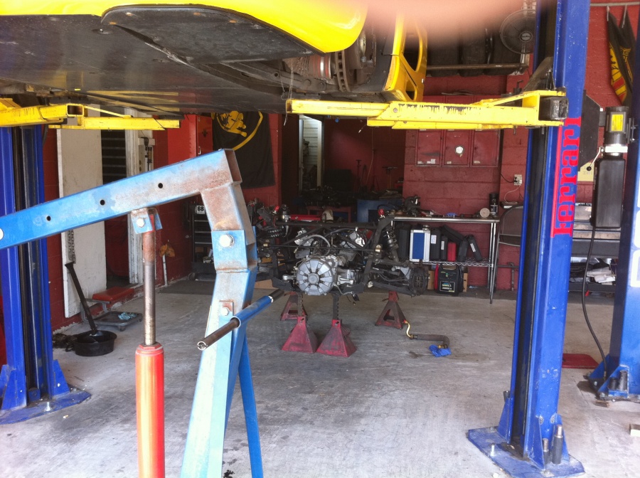

Yeah that's what they said to me. Then they followed with "go with the oem lowering option" then I think they refered to the x73 option. Then I got to thinking what's the difference.
It's at the dealer. To figure they would say that
Here is some pics of the rarri. Thats the motor out for its "major" service.
When I saw that bill I bought my 996tt.
Which sad enough she is in the shop right now. But I love the 996 because I don't need a 10k service every 30000 miles.
And I will add a little to this. While its at Porsche getting the "spoiler controller failure" fixed the stupid spoiler rams started leaking at the pump. But I will take this bill over the ferrari anyday.
