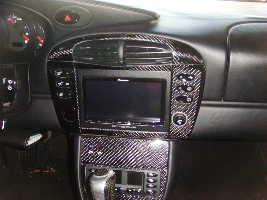

You are exactly where I was about a year ago... I replaced the speakers with Infinity Kappas, replaced the head unit with Pioneer AVIC120BT, replaced the AMP with Alpine PDX-5 and added a sub enclosure that I made at home. The sound is MUCH better now...

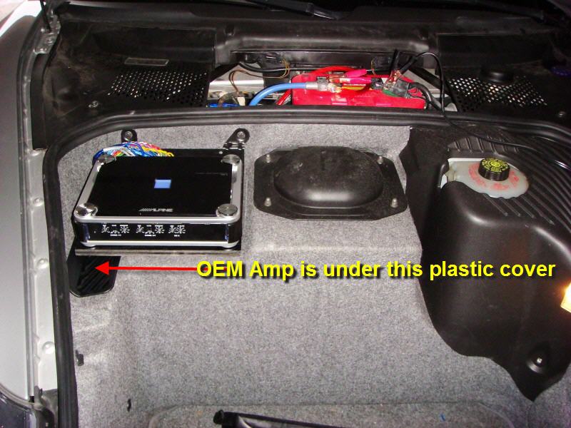

If you have NAV you will probably not be able to use the stock head unit with a commercial amp. The head unit will try to sync the security code and the AMP won't respond - so it won't work.
Here is where the amp is...
