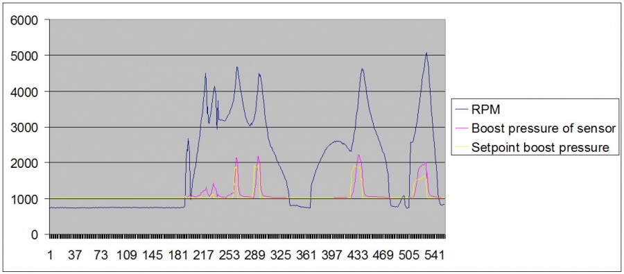

Datalogging the car:
O2 lambda looks even and curves are smooth, appr 0.73-0.77 in the critical range.
Cam-shaft angle sensors look consistent (doesn't look like dips/glitches).
They are both at 30 +-1 from 2500 rpm and stays there till 6000 rpm (had to release throttle at that point).
Actual boost vs setpoint boost:
Big deviation - with setpoint 1800-ish hPA - actual boost shows as much as 2200 hPA.
Last edited by REVS11; Jul 12, 2011 at 07:46 AM. Reason: EDIT: Logged boost values corrected
Big deviation - with setpoint 1500hPA - actual boost shows as much as 2100 hPA.
this would defiently send the car into limp. get a hand pump and check when the wastegates on the turbos "crack". a lot of pwople modify or tighten k24 WGs to sustain boost better and spool quicker. your tune
can you post print screens of actual logs?
what rpm were u seeing a 1500hpa setpoint? Thats low...
#TeamAIM

One thing that looks wrong to me is actual throttle angle:
- I do a run with gaspedal at 100% from 2000 - 6200 rpm
- At 4500 rpm the throttle body closes to 32% then gradually opens back up to 44%.
- That is synchronized with the boost sensor value reaching 2100-2200hPA.
My guess would be "overboost" or knock detection, so the ECU forces the throttle body to close up.
On other softer test runs, when I boost 0.8 (dialing the throttle to not boost more), the car runs ultra smooth.
My next step will be to put my stock actuators on these K24 turbos and try it as given the logdata it seems the K24 actuators (they are custom) hold too hard.
Does this seem like the right thing to do?
Right now it's a stock X50 file. So it should be "low". But the 1500 was misleading it was an isolated point.
I would see setpoint 1800-1900 but actual boost would be up to 2200+.
throttle closing is car going in limp mode most likely. it would help if you psoted the actual logs. you need a tune if you are running after market WG actuators. having them is defiently a good thing and a worthwile upgrade, i wouldnt take them off. i just think your tuner needs to make "boost request" adjustments in your map that are in sync with your hardware.
