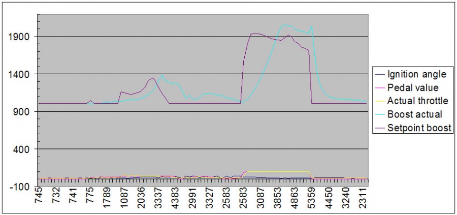

Adjusted the wastegates by simple tools and car runs much better.
WAS: Each wastegate started to released at 15psi and cracked open at 16 psi. It took 22psi to get near half open. Hm.
NOW: Wastegates start to release at 11psi and crack open at 12psi.
LOG: Tried appr 10 times to get a good log, but every time Durametric would crash. I reduced the sample rate to minimum and removed O2-sensor values and in the end I snuck in a half-a** run to 5000 rpm just so I could hit save before the program crashed again. It would run for minutes, but as soon as I did a hard pull it would end up crashing just as I coasted down to save the file.
At least it seems now the throttle body stays open at this level w/o wastegates being out of control.
Imo actual boost seems pretty delayed vs setpoint but maybe it's normal?
Your tuner need to change the pd/factor, if set to low you will get this result.
Thx!
+ He will change a lot of things.
This graph was taken with a bone stock X50 flash (no edits made yet), however actuators were upgraded.
