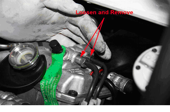

I wanted to add to this thread because i just did the delete to my car.
Follow the instructions to remove the drive coupler to stop the second pump for the clutch assist. Do a search and you'll find it.
using a 1/4"npt tap, i tapped and plugged the output from the back of the pump. Porsche feeds the pressure from here to the resevoir lid and then out to the clutch slave.
In this picture, "P" is the pressure input from the back of the power steering pump, "A" is the pressure output to the clutch slave, "T1" is the power steering return line and "T2" is the clutch return line.
You want to use a 1/8" NPT tap to thread into "T2" so you can use a 1/8" NPT plug to plug it. Use a pick to pull out the O-rings first. Only run the tap 3/4 of the way.
for "P" and "A", just find a nice plastic plug at the hardware store to plug them. At this point there is nothing running through them. Clean everything out with brake clean so any petosin can't eat your plugs.
