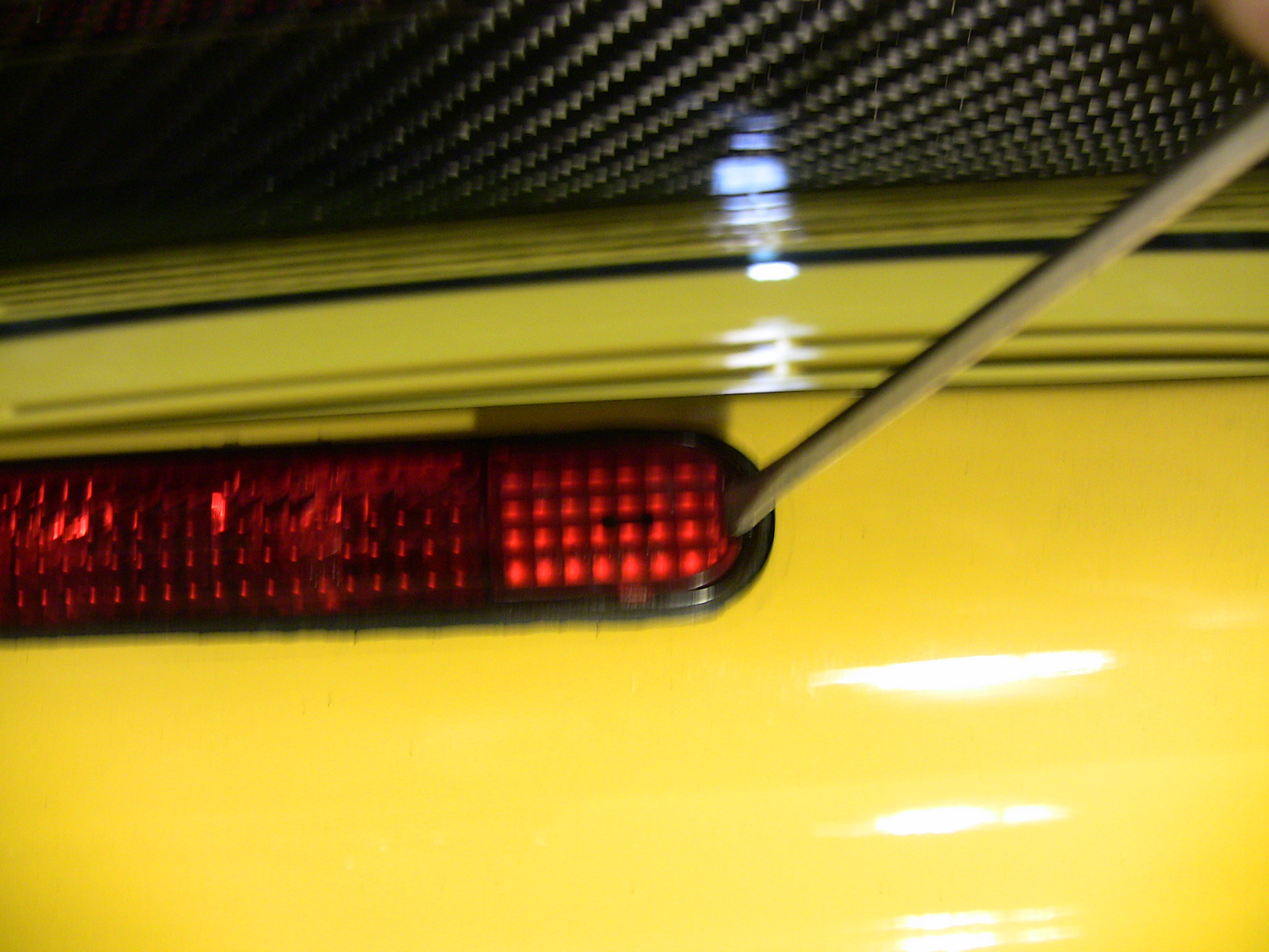

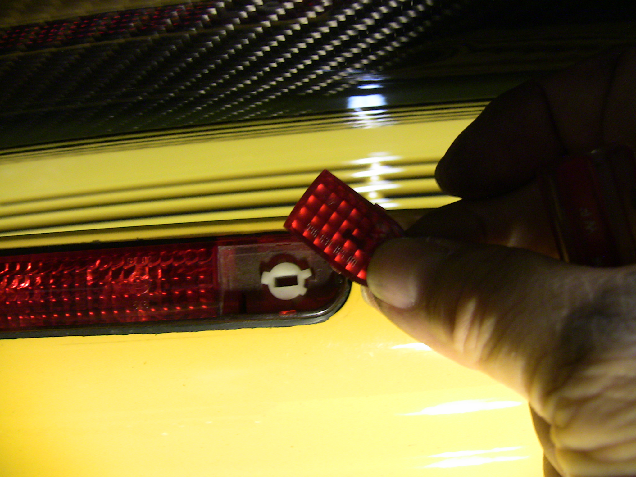

Remove the plastic end tab. There is a slot - insert a small screwdriver into slot and turn it a 1/4 turn. (forgot which way) Gently pry the lens out and unplug the pigtail connection. Install is the reverse.

Yup. Just did this. Pop the end cover off and then rotate the inner piece with a screw driver.

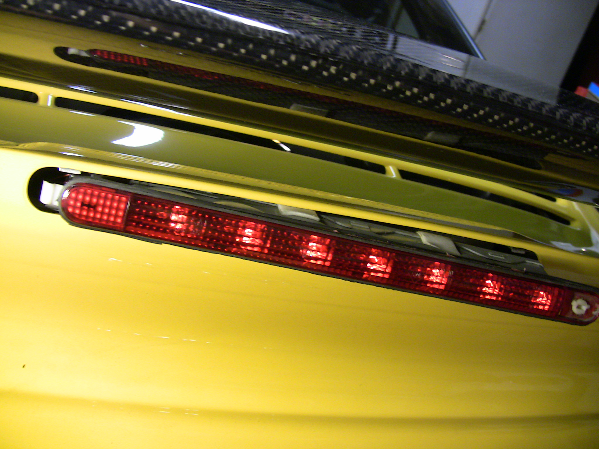

OK, here's some pix
I messed up my rubber trim also, when I was installing the AeroKit loom for a fix spoiler solution to eliminate Spoiler Malfunction Light...
then, figured out that I goofed by taking the light out from under the lid...
It's in the owner's manual, like someone said.

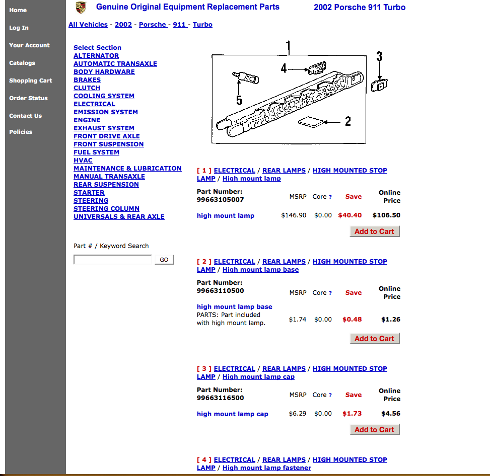

The whole light cost $106, so it's not cheap just to replace a bulb or the rubber trim...
However, the bulb is replaceable...
See attached...the bulb is #5 in the list, cost is $1.44
