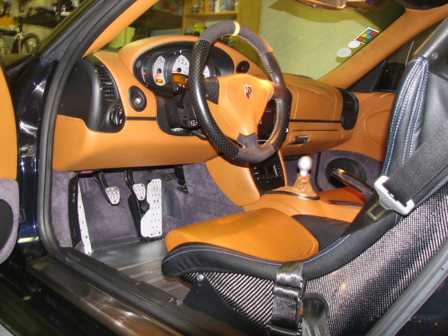

Here is a shot of the installed shift ****.

And another

That looks great!

Your installed **** looks super and probably doesn't get so hot. It somehow freshened up the interior...looks great.

That looks awesome, well done! I assume it has no issues with the OEM short throw option?
