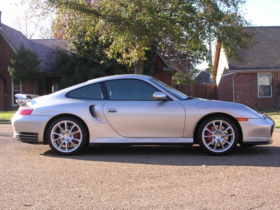

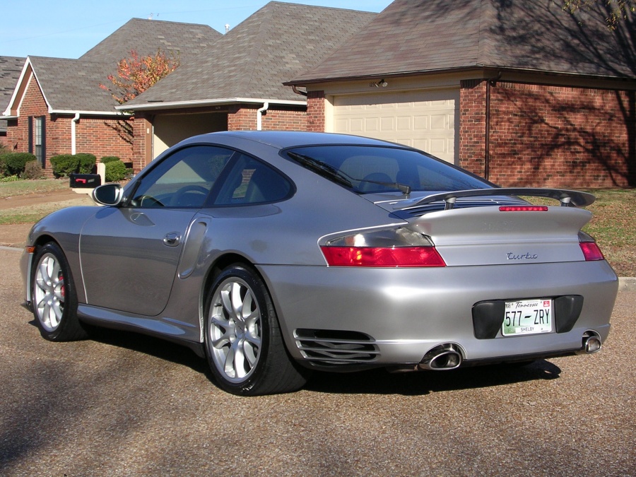

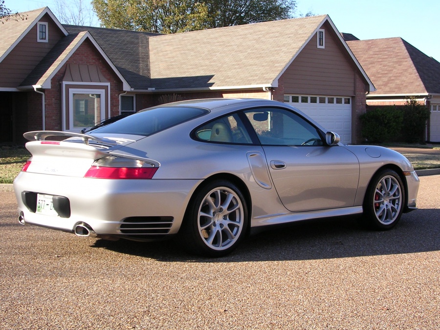

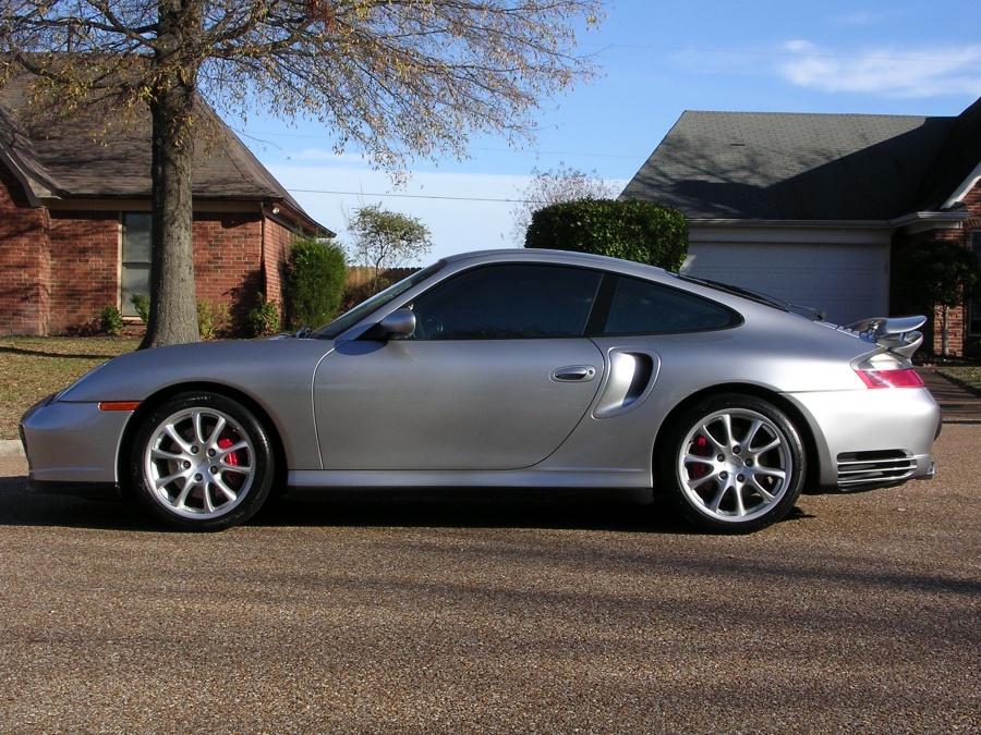

I am very please with the turnout

Looks very nice! Did you end up using spacers or finding a set of GT3 wheels in TT offsets?

Aero... I did go with spacers 18mm rear none on the front. These are factory GT3 wheels off a 2004 GT3. Was lucky to find these at the price I wanted to spend. I am SUPER happy with the end result. The offsets are perfect and they fit just about like the factory GT2 twist wheels that I had on before. Now I just have to sell the GT2 wheels lol Thanks again for the advice.
