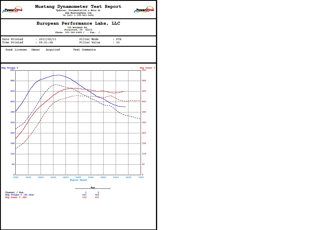

Hello all,
Have held off posting these results for quite a while now, figured it would help those people whom are debating these turbos and similar set ups.
Special thanks to Tony @ EPL ( and Dave!) for all the work back and forth, absolutely stand up guy who has gone above and beyond to answer my multitudes of questions, really enjoyed coming up to the shop for the day and watching how these guys work.
Also thanks to Chris Green @ USP motorsports for all the help as well.
Mods on the car (that make power)
AMS billet k16 with 1 bar actuators
Bosch Motorsports Diverter Valves
believe it or not this car has STOCK intake, air filter, plenums. ect.
Car is a 2003, with about 10.2k miles on it when everything was installed.
540whp,621torque.....and it wasn't that cold out either.
The car is able to be driven any time and maintains stock-like driveability until you really get into the throttle, no issues with the kit except that I was hitting the torque limiter and it had to be raised to that of a larger turbo.
Really have enjoyed this kit over the last year and a half (or so) and put just over 1,200 miles on everything (sorry its a garage queen)

Thank you very much for posting. Been trying to dig up these results for some time
This was on 93 octane? Boost? I didn't see any of that info on the dyno chart.

wow that spoolup is nuts. what is the difference between two pulls?
one was pre the inlet pipes, also done in warmer weather, believe the temp was over 100 in the shop with humidity. 2nd was after the inlet pipes in the spring of the following year. they made an ENORMOUS difference. I hope Tony will chime in at some point and give some info. I need to post the full dyno, will do tomorrow, Prodigymb, I like your new turbos, may be going the same route over this winter.

was 93, and 1.3 bar I believe. Believe its more on a conservative side and not all out.

When comparing the two graphs - are there any differences besides intake piping and air temps?
ie, any other mods done?

never got around to posting. Torque limiter was reached in the tune, I called Tony and in a second he changed my file, I reloaded and never had an issue again.

nope, nothing at all. Thanks, I like to keep it clean, I do some local concourses with the PCA.
