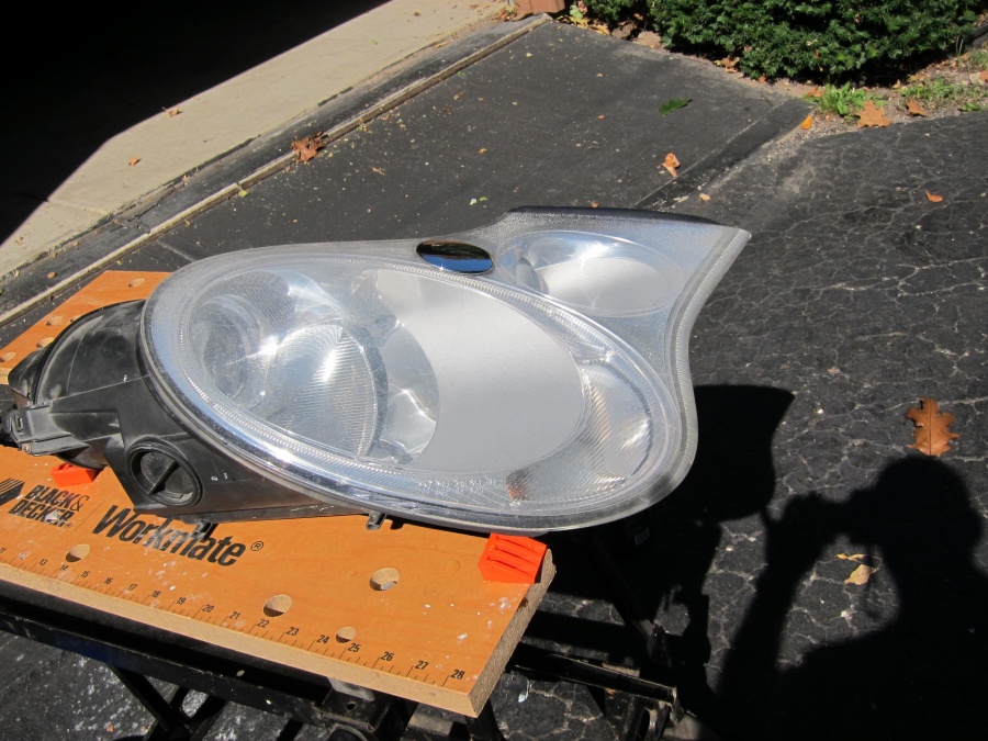

Had a little time this weekend, so I did a little restoration on my headlight lens. I had already tried one of those kits you see advertised on TV, but got nowhere.

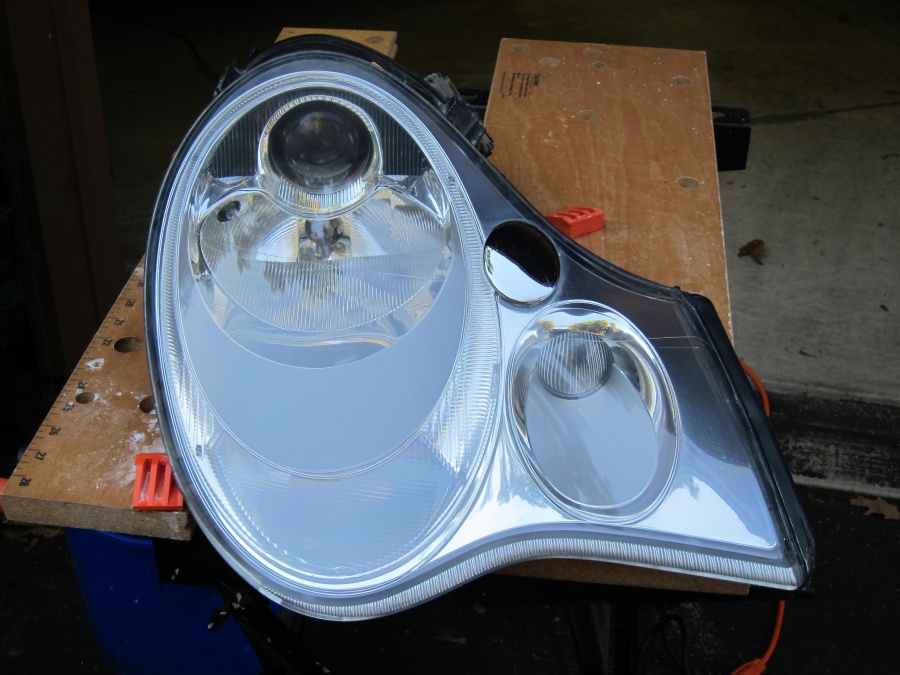

It was fairly badly pitted (see "Before" photo below). First, I wet-sanded with 600 grit to remove the pits (Photo 2) and then buffed it out with rubbing compound. It took a while - almost 3 hours - but the result was a big improvement.

Looks great! How did you work around that little chrome disk?
Carefully Seriously, that's all I did.

I think that if I had had some 2000 grit, it would have gone a lot faster. The jump from 600 to rubbing compound leaves a lot of scratches that it takes time to get out.

If you are not putting nothing over the headlights they will become worst like the first time because you took a layer of protection when you polished it.

^What he said. Originally the headlights had UV protection on them. Now that you have scrubbed those off and are not re-applying something, your headlights will only degrade more quickly.
Now I have only found 1 kit that actually includes UV protection. What are you guys using, just the 3M film covers?

OK! You guys convinced me. I have a set of Lamin-X films inbound.

I used the Meguiars restoration kit that includes the a bottle of UV protector. It does a pretty good job on medium to light scratches. Heavy scratches will require using a heavy wet grit sandpaper before using their product.

Had my car at a Sportech for some maint and one of the body shop guys in the same complex came by and said he could get them new for $100 or free if no improvement. He ended up removing the lights and wet sanding with coarse grit then finer and finer finishing with a buff. My headlights have always looked horrible but now they look brand new! I'm sooo pleased with this, and to think I was looking at new units on ebay for >$1200.
Now have to figure out what is needed to protect them going forward and sounds like a debate out there.
