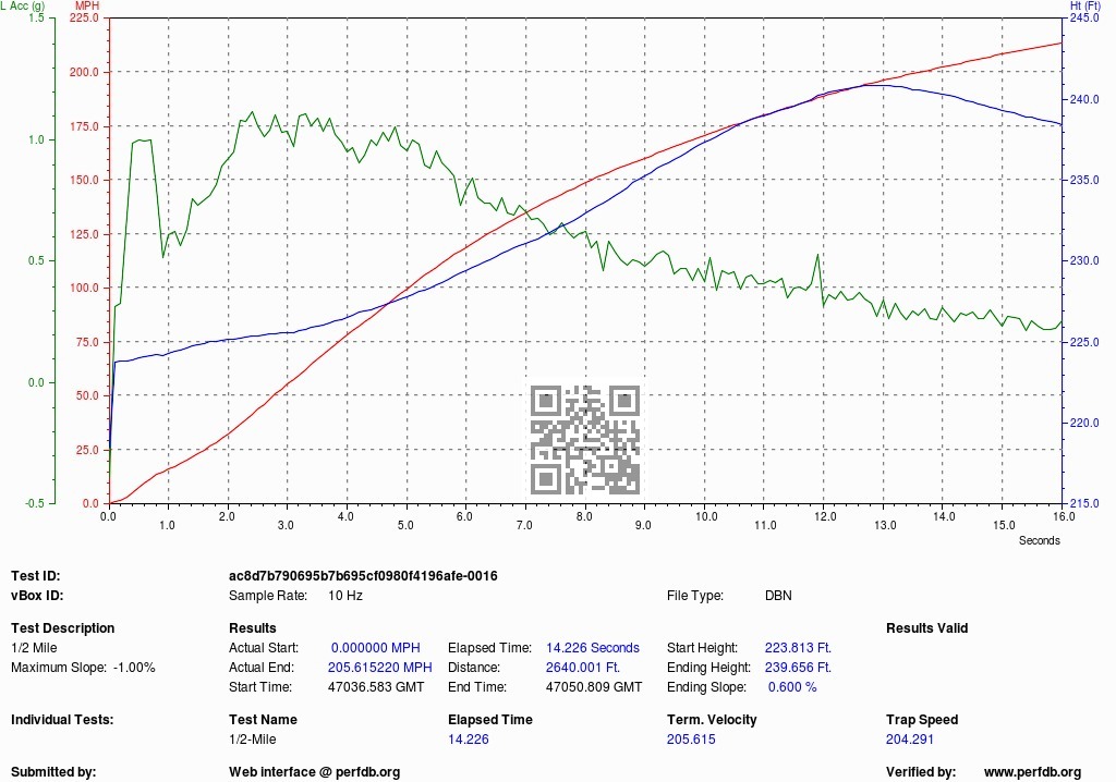

Does anyone have standing half file for a car in the ~200mph area they would post or share in feet?
I'm curious where I would be in the half if I added a GV
Doing around 175mph in 1600ft on the street now, wanna know how that translates to the 2600ft
I can't share the actual files with you, but I can share some technical details from the vboxtools.com database. Here's the three runs close to 200 MPH in the standing 1/2 mile, and their velocity at 1600 ft. Based on what I'm seeing here, if you're doing 175 MPH @ 1600 ft, then you'll be right about 200 MPH @ 2640 ft.
1/2 Mile Trap speed: 204.291 MPH
@ 1589 ft: 178.76 MPH
@ 1615 ft: 179.65 MPH
1/2 Mile Trap Speed: 200.926 MPH
@ 1576 ft: 173.983 MPH
@ 1602 ft: 174.916 MPH
1/2 Mile Trap Speed: 200.058 MPH
@ 1589 ft: 174.810 MPH
@ 1615 ft: 175.612 MPH
1/2 Mile Trap speed: 238.001 MPH
@ 1587 ft: 202.7735 MPH
@ 1602 ft: 203.443 MPH
