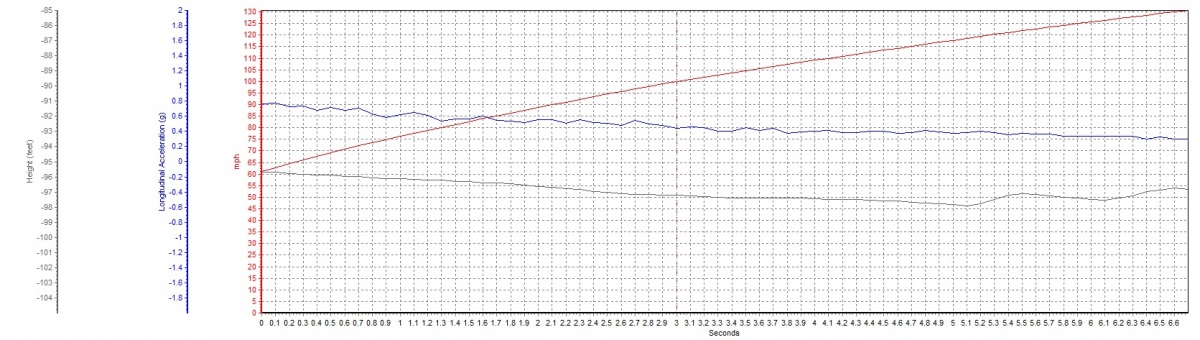

here is the 60-130 from the track....

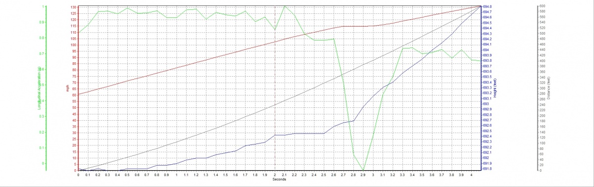

Guys
Got a file from member LamboTT (formerly Soundeffects) on his UGR Gallardo TT with a stage 3+ setup. He ran a 4.06s 60-130 slightly up hill on pump!!!
If he can find a little race gas and a downward slope the car could go well into the 3s, imo!!!
Congrats!!!
Name:	4.06s Lambott UGR GTT.jpg

Originally Posted by MBailey
Guys
Congrats!!!
I forgot to tell you, this is with me and Kevin from UGR both in the car! Take 1 person out and some travel gear (about 200lbs total extra) and I think that would put it in the 3's. I'll keep 6speed updated.
