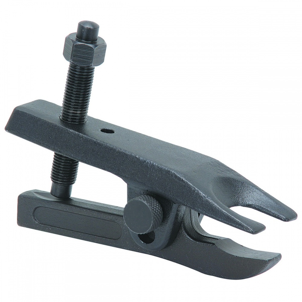

Ball joint separator I am referring to looks like this:
The link from Harbor Freight to buy it: http://www.harborfreight.com/3-4-qua...tor-99849.html

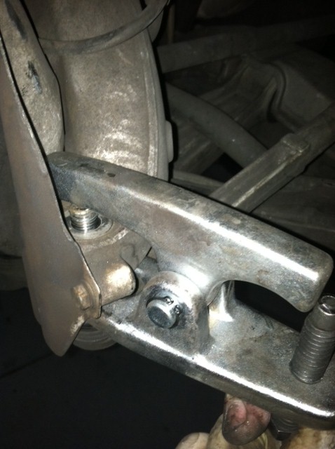

You would use this to separate the tie rod from the upright, and also to separate the lower control arm from the upright. This will allow you to swivel the upright around and slide the strut out of the upright and out of the car completely. The only trick to be aware of is that you'll want to use something like a dremel to grind down the ears of the ball joint separator a little bit to allow you the room to get into the ball joint on the lower control arm. It's not much that you need to grind out; I think it took me 5 minutes of working with it to make it fit into the control arm joint.
The tie rod and lower control arm ball joints are held in with 18mm nuts as I recall. You will want a Torx bit to lock the ball joint in place and then use an 18mm wrench to loosen the nut. You'll loosen the nut to the top of the threads and just beyond so that the ball joint separator applies pressure on just the nut and not damage the threads of the ball joints. This picture is an example of the lower control arm ball joint in the upright; it would be the same for the tie rod as well:
Here is a pic of the ball joint separator on the tie rod and upright:

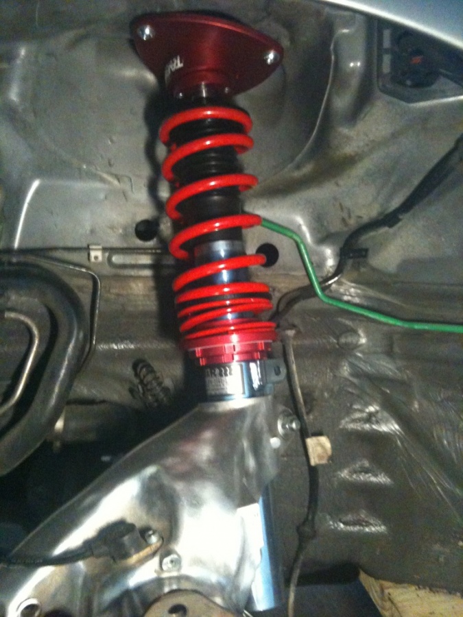

Once you have the strut out of the car, it's simply a matter of removing the top nut from the strut, which is a 22 or 24mm I believe? - It's been a while.
Once you've removed the nut, the strut top, spring, dust boot and all will separate allowing you to break down the strut. The actual strut bearing is located in the strut top (camber plate if you will).
Here is the diagram of the strut and what you're looking for:
The actual strut bearing:
I will say I've seen a DIY write-up that recommends you remove the entire upright from the car, and I will tell you this unnecessary and complete overkill. Once you disconnect the tie rod and lower control arm from the upright, it will give you room to swivel the whole strut assembly back and out to allow you to slide the strut out of the upright and out of the car easily. - Don't remove the whole upright; just not necessary.
This is a picture of my old H&R's in the upright:
