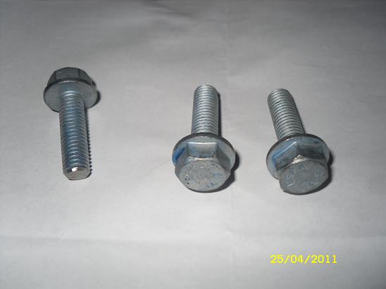

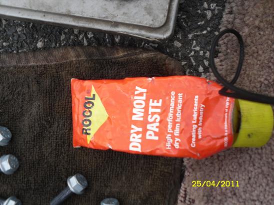

Yes the genuine bolts are plated 10.9 grade high tensile steel. you can see what the Porsche bolts look like in the pics below, they have 10.9 stamped on the top
I have never used stainless on exhausts due to lots of stories of it causing more problems than it solves. A lot of it may just be internet legend though.
I've found the dry moly paste to be better than copper grease type stuff.
The copper stuff eventually disapears and after a couple of years the bolt is just as hard to remove as one fitted dry.
The dry moly will still be there and the bolt will be easy to remove, thats been my experience anyway, unfortunately its expensive.
By the way I've had good results with the freeze type penetrant sprays as mentioned above, they do seem to work better than the traditional sprays, I would spray the snapped studs for a good couple of hours before you attempt to remove them, you want do everything you can to make it easier.

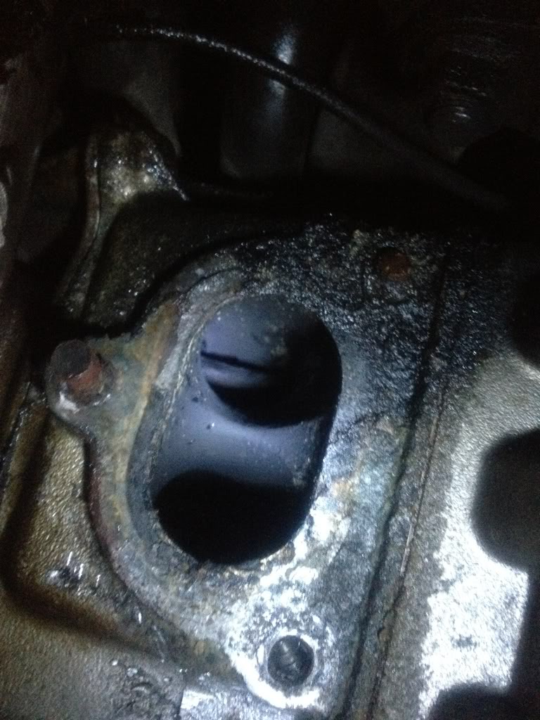

I haven't got the sheared ones out yet, I think that'll be my weekend job
As I can't undo the final bolt holding the left manifold in place my intentions are......
Grind the bolt head off
This will hopefully allow me to remove the manifold (I say hopefully, as the turbine studs and sheared studs in the head may stop it being removed)
With the manifold removed I'll soak the sheared bolts with penetrating oil
After soaking I'll then try and remove the bolts
If there's a lot of thread protruding from the head I may be able to get two nuts on it and try and remove it that way
If not I'll try and get some grips on them to turn them
If that doesn't work I'll try a stud extractor on them
I'm still trying to work out the best approach for the stud extractor though
If I have to go down that road, I can't decide whether to refit the manifold (to act as a guide for my drilling) or to grind the bolt flush with the head and then use the extractor
I guess I'll have to remove the manifold first to see just how much thread is sticking out, I think that'll make my mind up for me

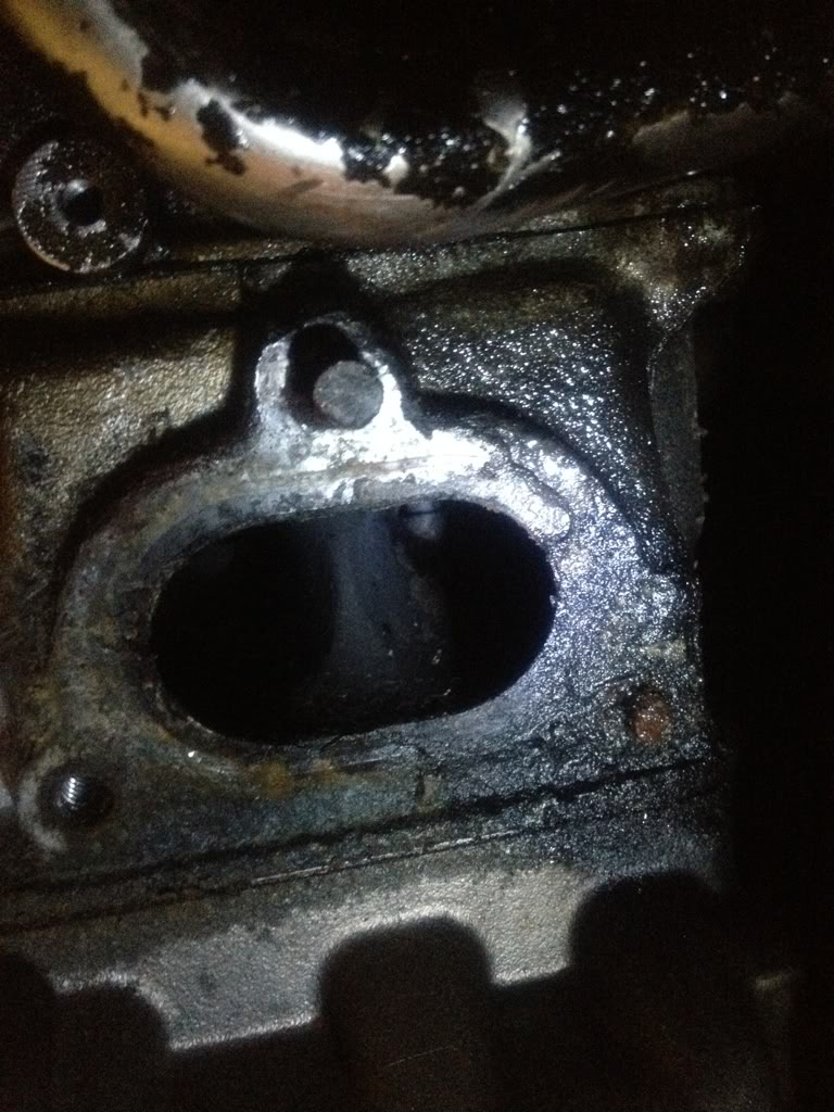

Another method i've used in the past if you have some stud left sticking out, is to place a larger sized nut over the remains of the stud and mig weld it to the stud. This gives you a good big nut to turn.
On the last one I did like this I used a whole can of freeze spray. The stud started moving but would only move a tiny bit then went tight again.
I was patient and made sure I didn't turn it too hard, I kept at it with the spray and slowly got it to move more and more and eventually got it out without damaging the thread in the Head, I would try this method before you try the stud extractor method if at all possible.
I think the heat from welding the nut on also helps to loosen the stud
The worst that can happen is it snaps off again and your back where you started
I'm not usually lucky enough to have some stud sticking out though.
I think I still have the last stud I got out in the garage somewhere I'll see if I can find it and post a pic.

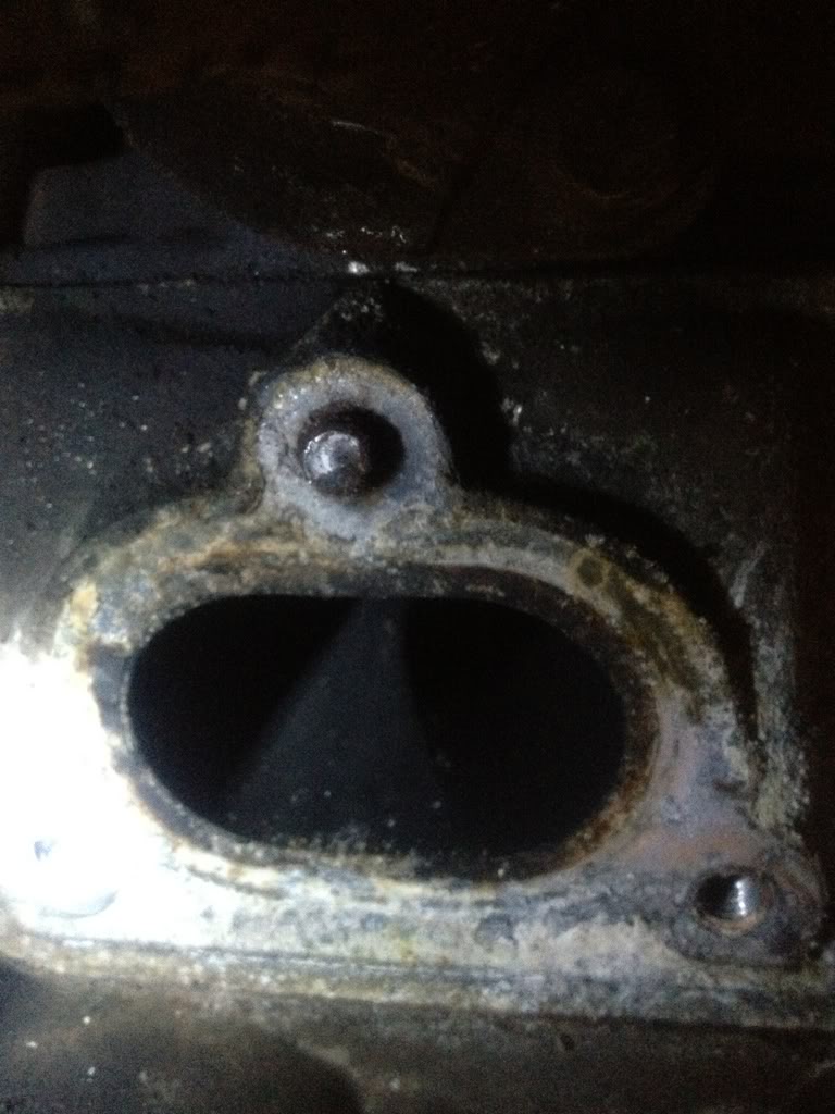

I've just managed to grind the head of the last bolt, but still can't get the manifold off
I can put a pry bar anywhere along the manifold and it'll move - except for this last bolt (which is now headless)
I would have thought with a little perseverance I would be able to wiggle the manifold off
But now it seems the bolt is stuck to the manifold
Has anybody got any suggestions on how to free this bolt and the exhaust manifold?
Should I keep going with the penetrating spray?
Once I've got the manifold off I can start working on removing the sheared bolts

Ok, I've got some good news
I've managed to beat the manifold off the car!
The bad news is I can now see what I have to work with

Anybody got any ideas what's caused those bolts to corrode to that extent?
Some of the filth you can see is the penetrating spray, but what would account for the rest of it, and why are these studs so bad compared to the others?
Id like to resolve this before refitting the manifolds
Also, now ive got some pictures for you has anybody got any suggestions regarding the removal of those sheared bolts - or should I just go about it as previously discussed?

One of your bolts was fractured a long time ago while installed. Try cleaning the threads well with a chaser and use some never seize. I shouldn't have to say to torque and re torque to the manufacturer's recommended numbers.
