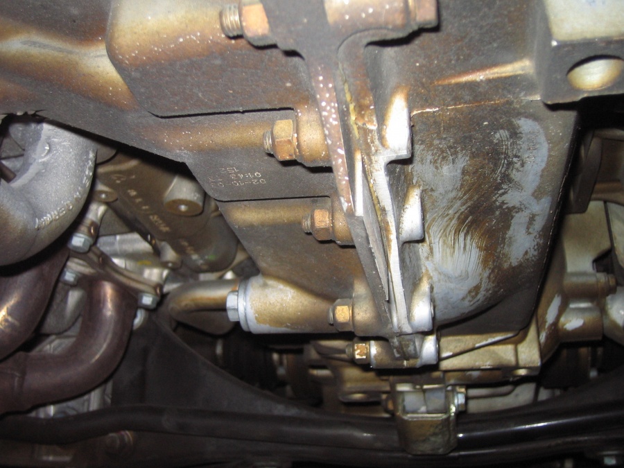

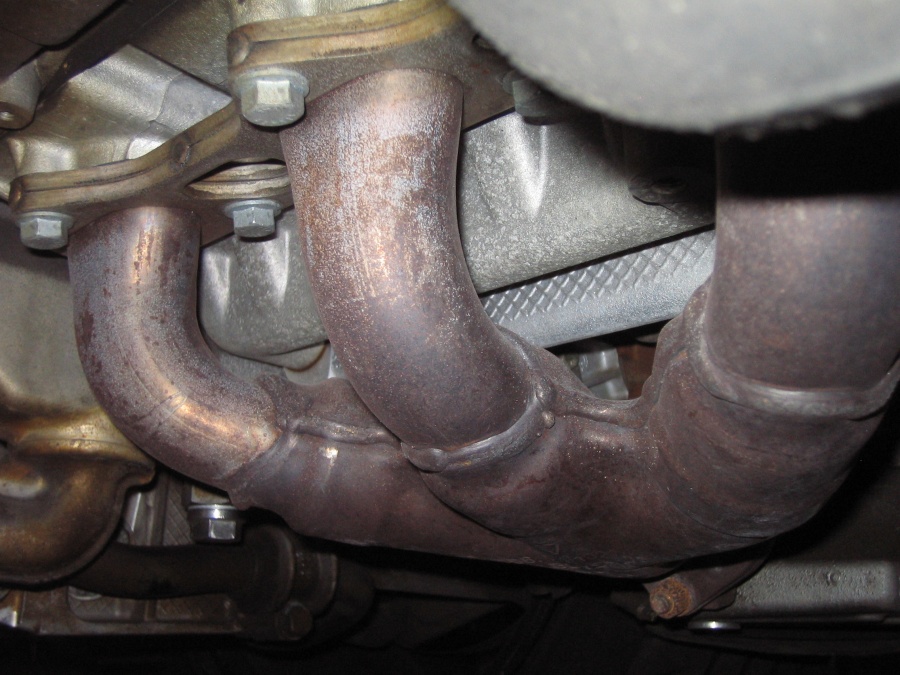

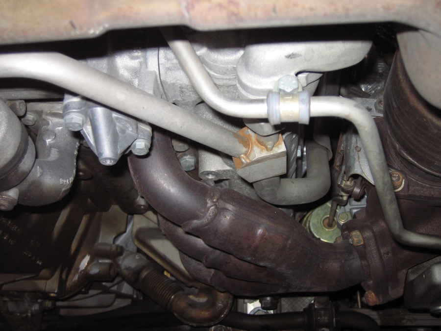

Thought you might like to see what a car that has lived in a dry climate looks like from the underside. Generally a joy to work on.
