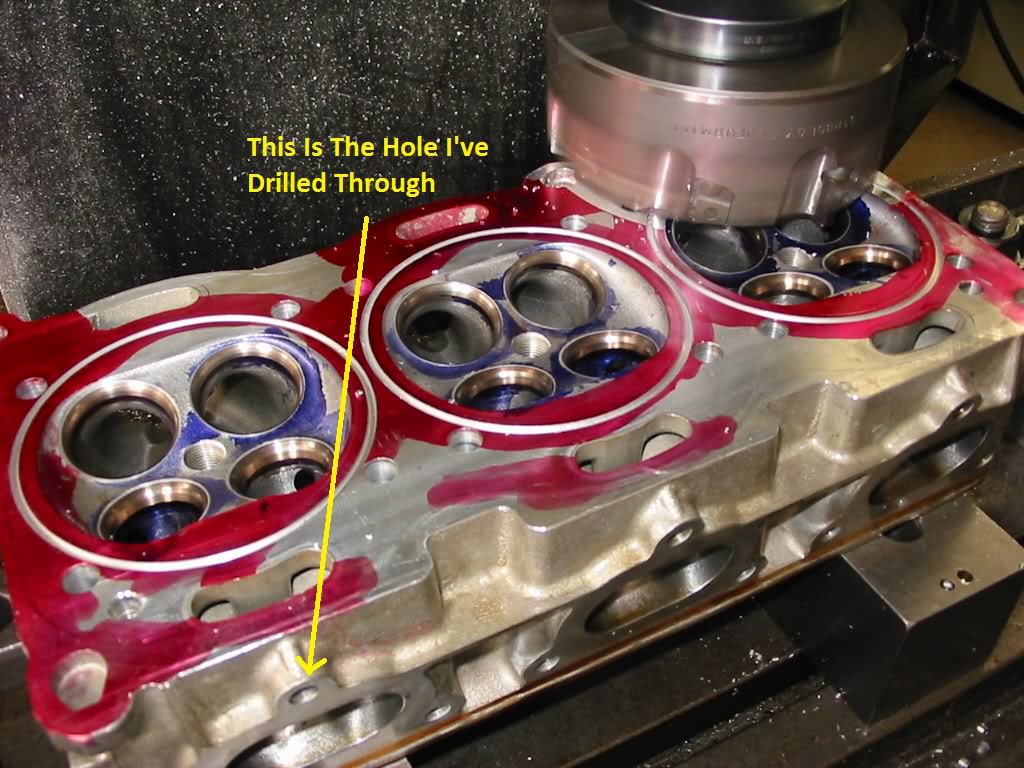

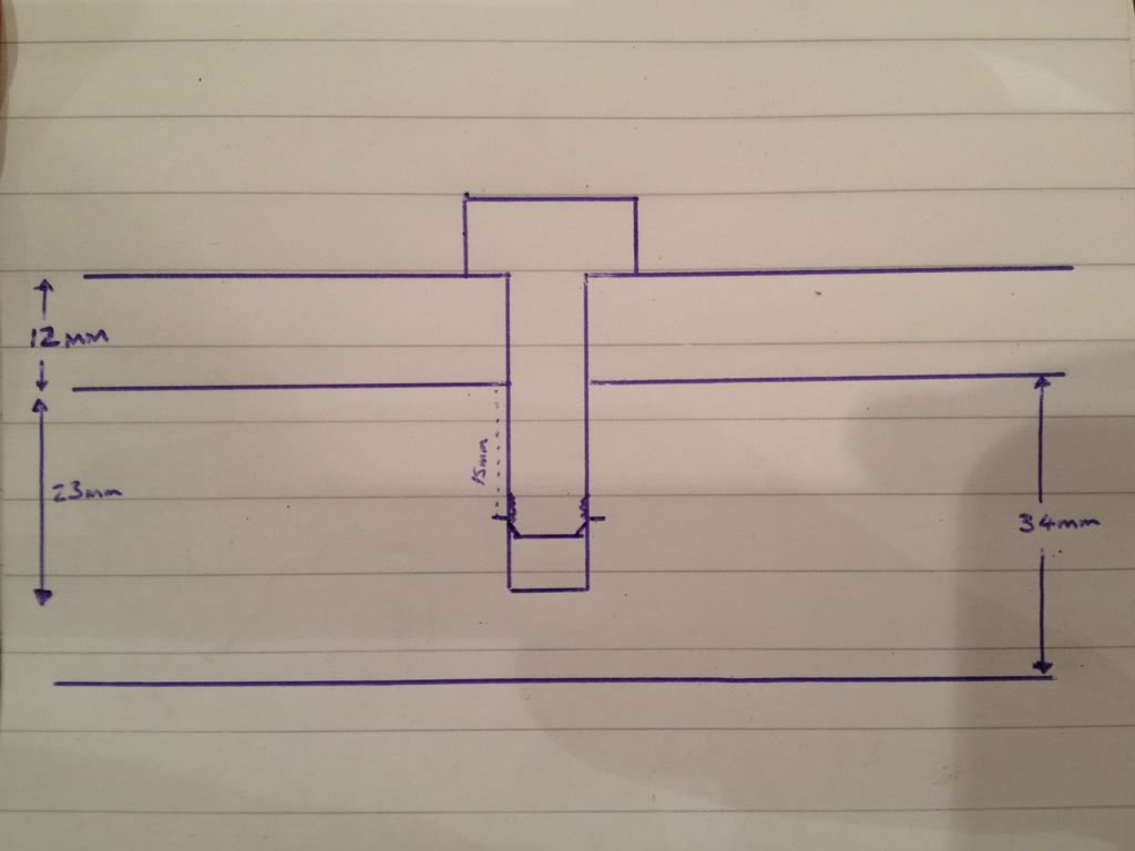

If you drilled into the jacket with a 5.5 mm bit, that's about .220". You need about .242" to start the tap. So you'll need to enlarge the hole to a drill size "C" or .242" or 15/64" or 7/32 should if you can't find the other sizes.
Keep in mind, first you'll want to drill and tap the 8mm hole to a depth of the original. I'd actually go about 4mm less leaving more material for the plug. If you have 40mm total and need 30mm for the 8mm diameter bolt, I'd go 26mm leaving 14mm for the plug. After the plug is installed you can always drill and tap the 8mm hole a bit deeper.
Important: You'll want to grease the tap to catch chips and go slowly removing and cleaning the tap after a couple of turns. Keep the chips out of the motor. Also if you go too deep, your f'ed. Remember your cutting a taper, and depth of threads is very critical. You may have to tap a bit, remove the tool and check engagement and depth of the plug when tight. If you tap too deep the plug will go into the jacket and fall through.
You need to think this through very carefully and do a few dry runs in your mind or a few tests on some sacrificial material first.
Most importantly, see if you are able to grind down the largest OD of the tap to be effective and have it fit into the 8mm threaded hole. I made of pic of how the modded tap should look here. The red area is where you have to grind it down to fit in the hole, blue is where you made the extension to drive it. Hope this helps. No guarantees it will work, I'm home and away from the shop so I can't look at or measure any of this stuff for you. Day off today, cold and snowing. I'll be hiking later in the mountains. Good luck.

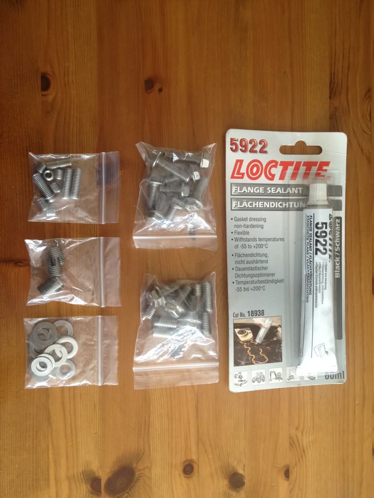

Ok, after speaking with as many people as possible I decided to tap the whole thing to fit an M8 set screw/grub screw
I prefer the idea of the tapered pipe plug, but it seems a little too much for me
Im going to apply RTV sealer to the set screw in order to seal it
RTV sealer is a slow drying, flexible setting paste that changes to a pliable, non-hardening film when the solvents evaporate
It works between -55*c to +200*c
So it should be more than capable of holding up to what I need of it

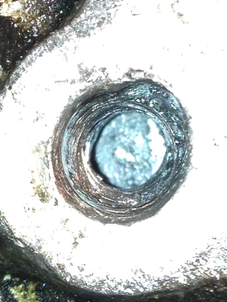

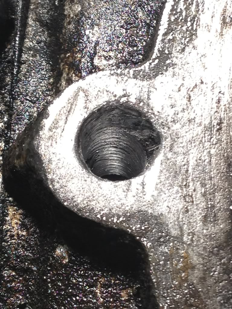

So, here's where I am right now
I've tapped the hole to fit an M8 thread
However, the hole I drilled was slightly off centre to begin with - as mentioned previously
Now that I've tapped the head I can see there's a slight problem with the hole
The hole is perfect further down the thread, so the plug will be fine, but due to the oval shape of it to start with, the manifold bolt doesn't have quite enough material to bind on to which causes it to wobble at the start
Once the bolt is in 5-10mm everything is ok again
The bolt is meant to go into the head by 20mm so there's still enough thread there for it, but I'm not happy with it
I don't know whether to try it as it is first, and then fit an insert if it still bugs me

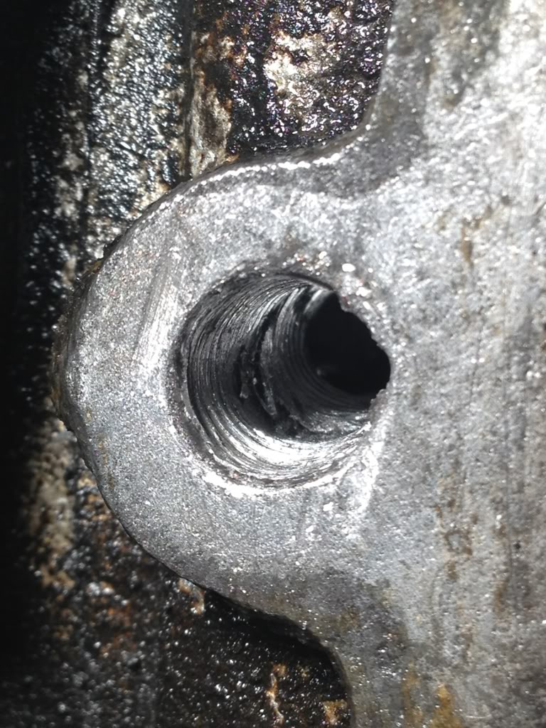

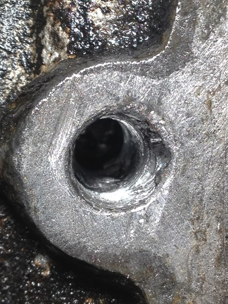

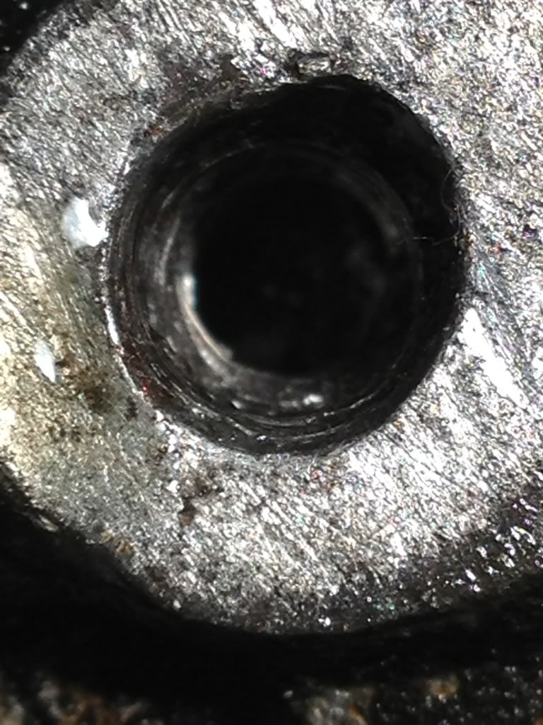

Here's some pictures for you
It's the same hole in all the photos, just taken from different angles so you can see into the thread

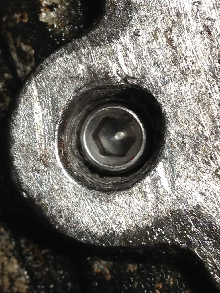

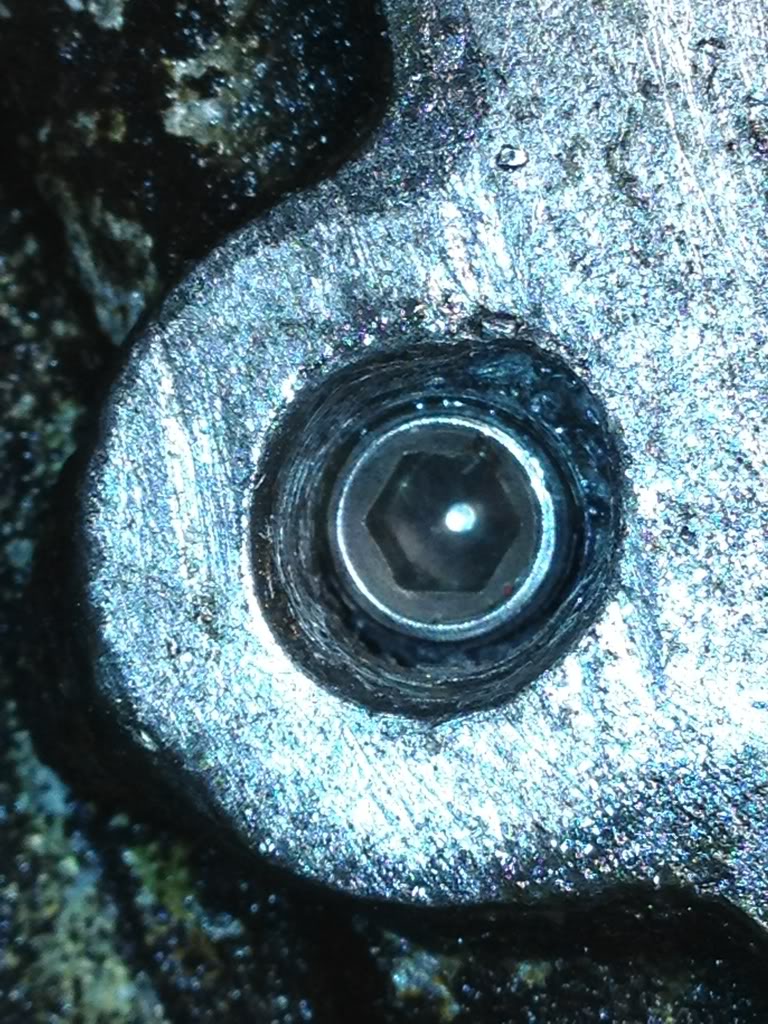

Well, I decided to test fit a bolt into the hole I'd tapped just to see if it'd hold
If it held then knew I could install the plug to fix the hole in the head
I've installed the plug and have just drilled my final stud out
I think I can now say with absolute certainty that there's something not quite right with my cylinder head
I was drilling my final bolt - I hadn't even got to the required depth, and the ****er went into the water jacket again!
I'm not impressed in the slightest
I was just approaching a depth of 20mm and the head leaked coolant again
Well, I'm not angry in the slightest
I honestly couldn't care less
I think I might take the engine out and take the head off to be welded now
That should be a good way to waste a lot more of my time

I've ordered a variety of bolts, screws, washers, and inserts
I ordered a few of each in various sizes so I know (hopefully) I've got all bases covered
I got some RTV type silicone sealant too, which will go onto the studs

Ok, some questions......
(and of course, some pictures)
If you remember, here is a photo showing the hole which I have drilled through
I have taken some measurements and have the following dimensions:
Manifold Bolt = M8 x 30mm
12mm = Manifold Flange
23mm = Original thread depth (in the cylinder head)
34mm = Total depth of head (to the back of the water jacket)
Note:
The 15mm is the depth of the insert, should one be required
So, whilst the bolt has a 30mm thread, it only goes into the head by 18mm
(30mm thread minus 12mm manifold depth)
And as the head is originally threaded to a depth of 23mm, there is a 5mm 'void' at the bottom of the bolt
I fitted a M8 x 25mm grub screw/set screw into the hole, to test for fitment
With the screw inserted as far as it will go (until it hits the back of the water jacket) it is 'sunken' by just over 8mm
Hopefully these pictures show the back of the water jacket
And these ones show the 25mm set screw trial fitted
Look how big the hole is initially - I'll definitely need an insert or some way to fill that hole
Now then, as the manifold is 12mm, If I were to try and fit a 20mm manifold bolt (instead of the 30mm as previously used) it would but up against the set screw with no 'void' space
I could fix this by either using a washer when fitting the bolt, or by using a shorter set screw
I am very much aware that I don't want to use too short a screw though for fear of it falling into the head if it's screwed in too far
The main problem I would have with using the 25mm set screw though is that if it is only 'sunken' by 8mm I would not be able to fit the insert into the head (as it's 15mm long)
So then, in order to fit a 15mm long insert I would want to use a set screw of less than 19mm length
(34mm total head depth minus 15mm insert depth)
Something I can't decide on is, should I fit the longest screw possible and fit it until it buts up against the water jacket, or will this restrict the cooling system too much, and would I therefore be better off fitting something which doesn't pertrude into the water way?
You can probably tell from the pictures that i'll need to fit an insert or do something in order to be able to fit a manifold bolt securely in place
Would it be a stupid idea to use some kind of liquid metal to level off the hole after the set screw is fitted, and then just drill it again?
