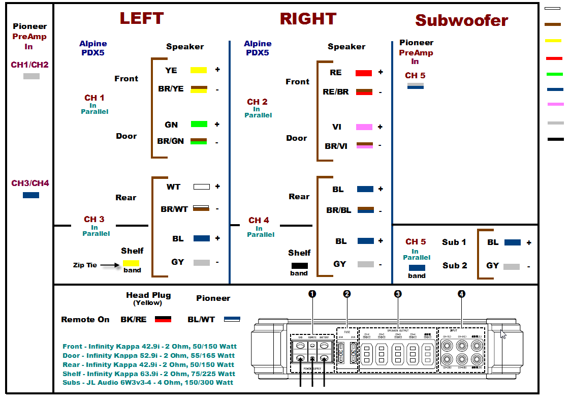

I hope you are not expecting direct replacement with those sizes... The door speakers are 5 1/2, but you can get 6 1/4 in there if you rework the mount. The dash speakers are 4 inch just like the rear. I replaced all of my stuff with a Pioneer Z120BT, Apline PDX-5 amp and replaced all the speakers with Infinity Kappas of equivalent size. I topped it all off with 2 x 6.5 inch subs in a custom enclosure. I had the room to add a couple of 6 1/4 speakers in the same enclosure as the sub - so I did. It all worked out quite nicely and the sound is amazing.

^that setup looks great! I'm going to guess you like CF? lol and yeah, I know I'm going to have to do some work to fit the door speakers.
Just curious, how did you wire up all those speakers to the pdx-5?

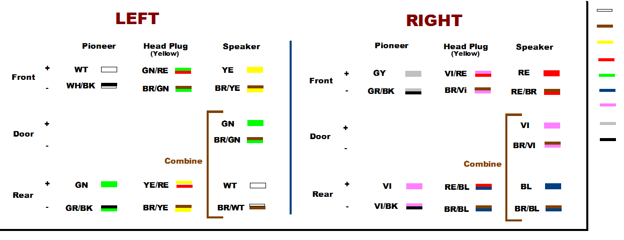

Originally Posted by randomquickness
...Just curious, how did you wire up all those speakers to the pdx-5?
OK, since you asked, here is the wiring diagram for an 01. I'm hoping the wire colours are the same for everybody...
Amp wiring:
Speaker Wiring (disregard the speaker wiring on this - I did this before I had the amp):
I hope this helps.

Thanks! that is very useful and I'm sure many will get good use from it. I was just curious how you balanced it all out but I see now with the parallel wiring.
