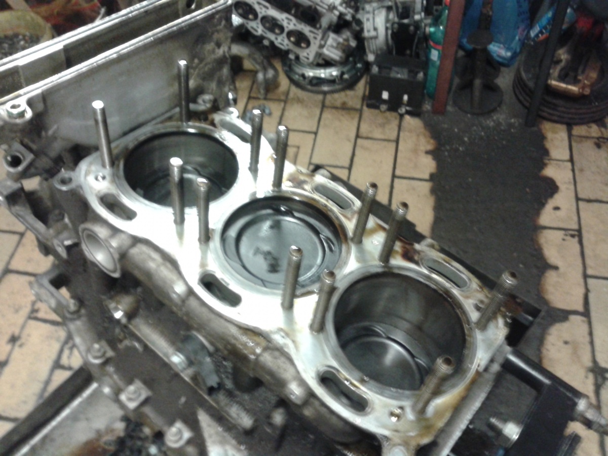

very light engine build
Pauter rods
Raceware studs
new headgasket
maybe heads porting
going to keep stock oil pump, actual lifters etc etc
everything looks good on the inside, car was seeing 1.35bar on pump and 1.5 bar on ms109, just some o-rings and minor stuff to replace here and there... , for sure flash was really good

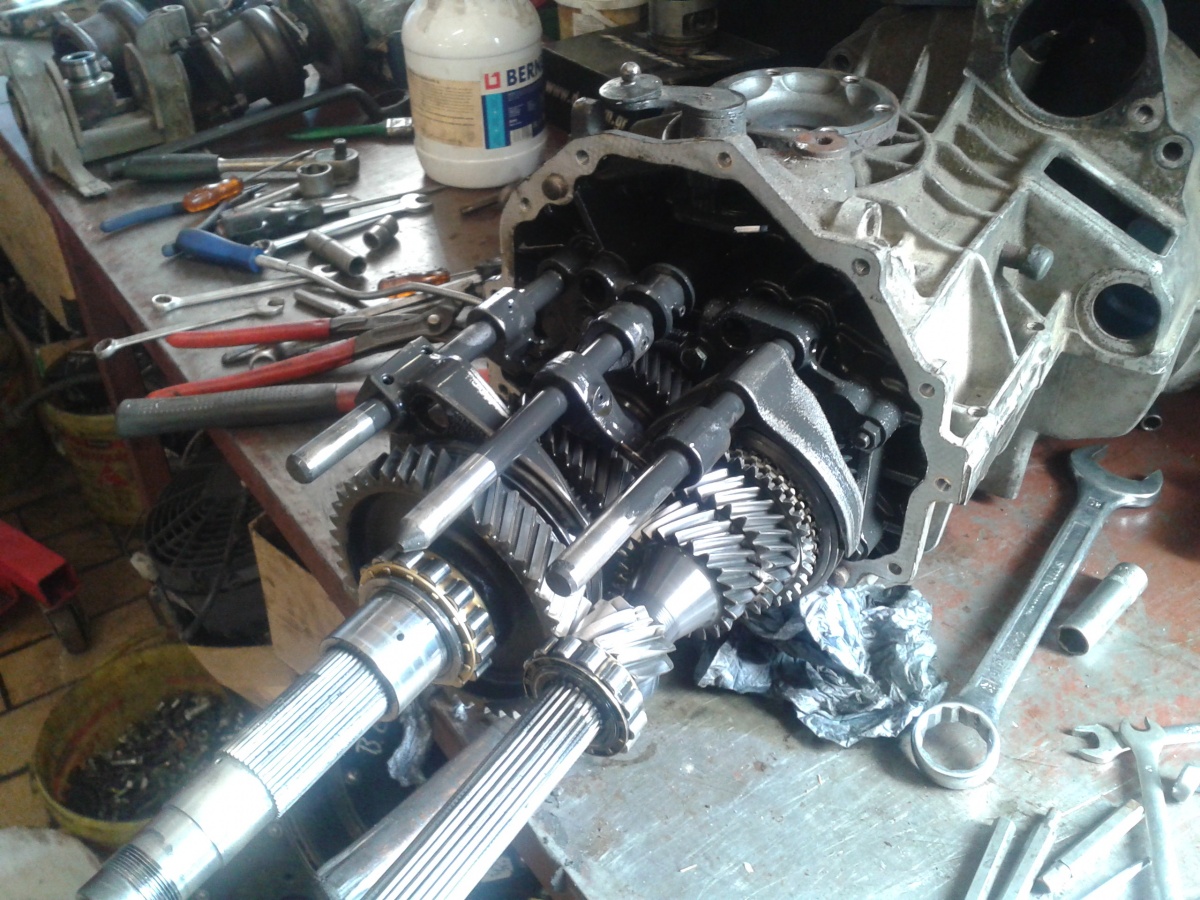

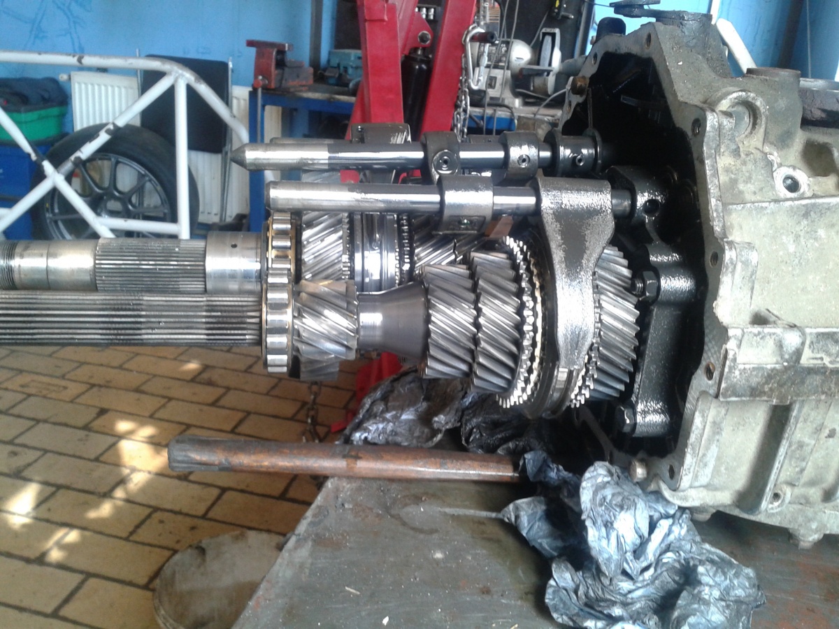

gearbox surgery...
The only real problem - 2nd gear mainshaft shows what happened there , car was seeing just a few times 1.5 bar on A3076, small stuff to replace, normal for this kind of car, mileage and abuse...
Otherwise a perfect looking and strong gearbox, if going to replace the mainshaft will do 997 gt2 and rebuilding 1-3 gears
Also some differential bearings might need replacement, not sure will add a LSD for now as i dont really see real benefit for straight line acceleration

So I assume you bent a rod or what was the reason for the rebuild?

Rods are fine, i will put some pics soon, reason is I want to run much more boost than 1.5bar on alphas and i want to be as reliable as possible, i dont want to risk running that on stock rods
I will add much more than just rods...

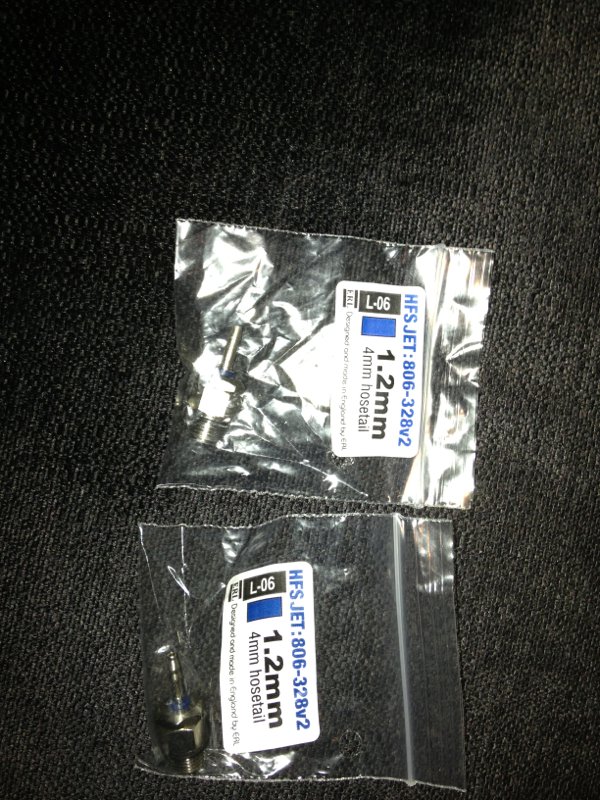

Some goodies

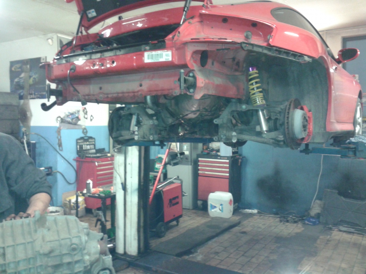

A few more to go in...
ERP RPS triple carbon clutch
Custom 30s with external gates, not shipped yet but on their way to papa
305/35/18 MTs
997 gt2 gearbox
other stuff including 80cc injectors

Took a lot of time and work to finish up the gearbox, all in one piece now.
After a light porting job and changing rods .... just a little more to throw pistons in and than setting up timing and we are done with the engine too, lots of things waiting to be done in the end... headers, turbos, new fuel system
Soon for sale my old fuel system good for up to 850hp with 60lb injectors, CM stage3 clutch, ported headers, A3076 turbos and more
