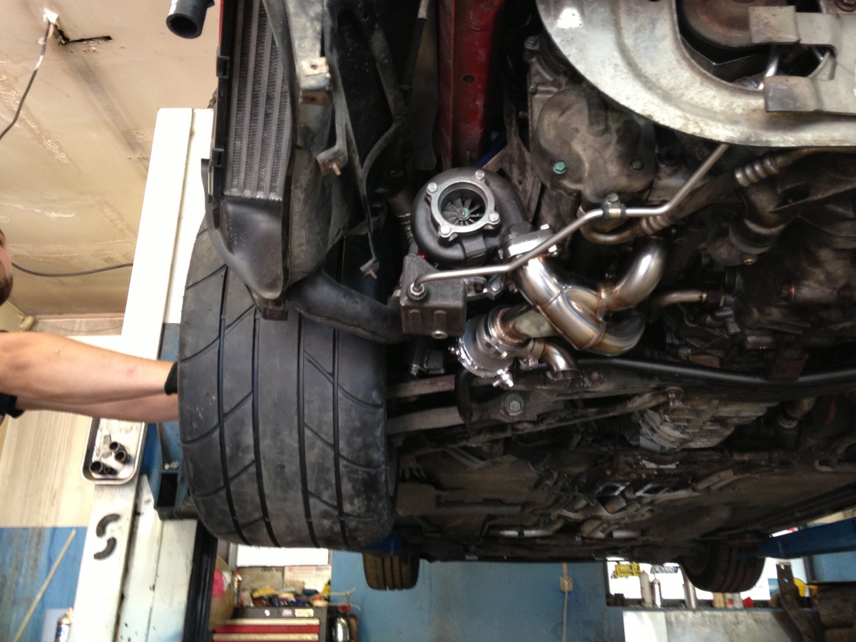

Thanks!! Hope so too... Added a few more pics... Manual porting job, headers and turbos... All waiting for 2bar of boost

Those headers looks nice, just like Marski headers The turbos looks great also just like some custom turbos from 911tuning , enjoy your new found power!!!

Yes indeed, some custom custom30s headers are nice and light, thank you !

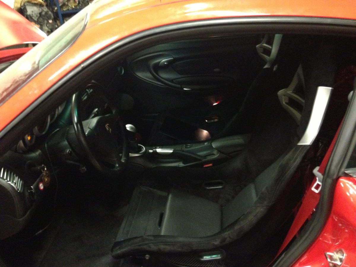

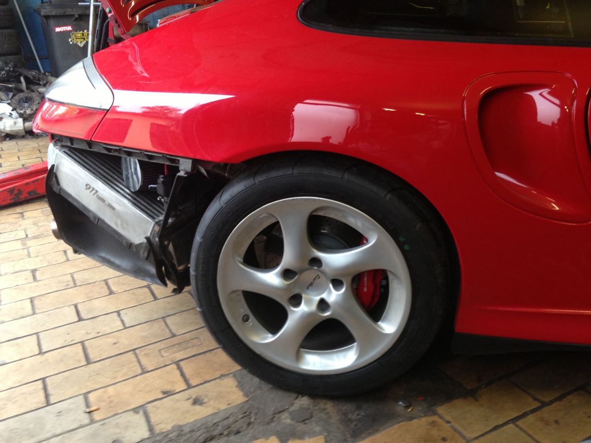

works in progress
new tires, light seats, fuel system

Lookin' good, brother! Can't wait to see it all come together - with results.
