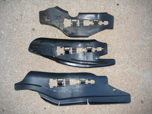

Originally Posted by pwdrhound
k. These are the part numbers of the front and rear brake ducts that are a direct drop in fit on the 996tt:
front GT3 cup:
996-341-117-90
996-341-118-90
rear GT2:
996-331-127-90
996-331-128-90
By the way, I just ordered the rear gt2 ducts from pelican parts - $90 per side. My rears are definitely getting hotter than the fronts so every bit helps!

Originally Posted by muker
It seems that pwdrhound found a good solution though. His calipers look perfect after several track events. By the way, here is a nice pic of the front air scoops: stock, gt3 street, gt3 cup. big difference!
The bottom duct in your picture is what you want. It's not the cup duct but very similar. The 996 Cup car duct (the part numbers I gave you) is actually a made from two pieces riveted together and is even marginally deeper. Take a close look at the picture of the duct in my early post and you will see the difference. The Cup duct is actually an OEM 996tt duct with an extension riveted onto it by Porsche Motorsport...
Another thing you can do is go to larger 350mm rotors and the 6 piston calipers. Both will help dissipate heat better for track work. I run 350mm floating slotted front and rear....

I looked at your picture and can see the difference. Someone posted this picture with the caption as gt3 cup but but I see what you are saying. I know I will eventually have to move to larger brakes and rotors.
