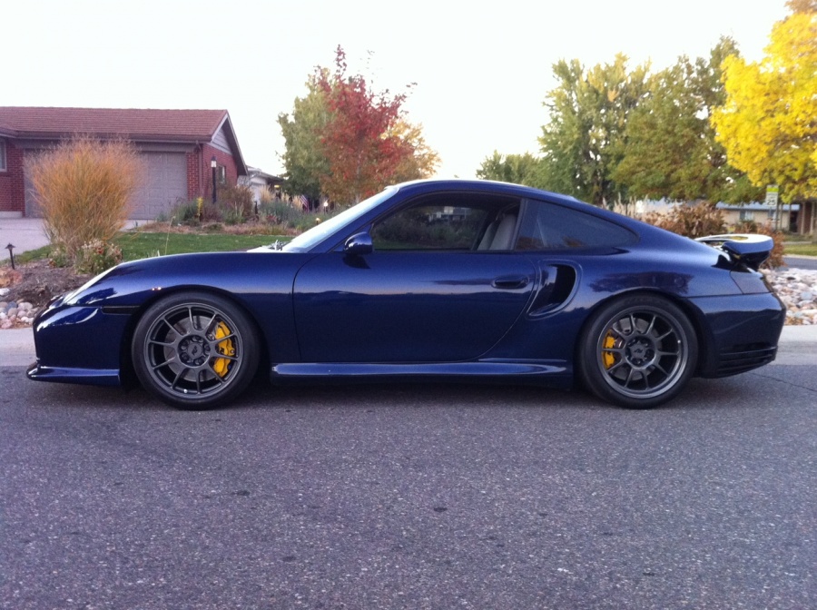

You need to remove the calipers from the car and have them sandblasted down to bare metal, degreased, primed, painted and finally cleared with high quality high temperature resistant paints... I had my calipers professionally refinished and have not had any issues at my local track which is notoriously demanding on brakes. Total cost was about $700 including shipping. I did the R/I myself. Good luck......

Thanks a lot for the advise. I may try one last time with new materials but and stencils but at best my odds are 50/50. To answer your question I am running the stock GT3 ducts - where did you but the large cup car gt3 ducts and the GT2 rear ducts? My rears are the ones that looked worse so any way I can get more cool air would really help. Thanks!Originally Posted by pwdrhound
Are you using the small stock GT3 ducts or the large cup car GT3 ducts that I have in my picture? I highly recommend the Cup ducts as the stockers are tiny in comparison and not much better than stock. I also run the GT2 ducts in the rear. http://fastforwardwheels.com/

I had the same problems that you have when I first took my car to the track. I toasted the rear brakes and the calipers turned orange. Based on my experience, the ducts in the rear are a must, especially if you run with PSM ON since your rear brakes will be constantly pulsing to keep the rear end in line. At the very least, run with PSM OFF (even though it will not be fully off unless you disconnect the connector at the ABS pump) and that will help a lot as PSM will only be functional under braking but not acceleration. The rear GT2 cooling ducts are a must otherwise you have zero cooling in the rear. I've seem more rear brakes cooked on the 996tt than the fronts. I bought the Cup ducts through my local Porsche dealer that I have an account with. PM me if you need help sourcing them but a Porsche dealer should be able to get them for you. They are about $500 for all 4 corners....money well spent. Originally Posted by muker
