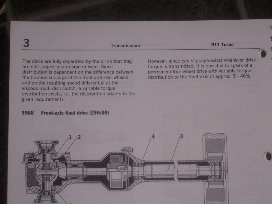

Here is what the Porsche Service Information Tecknic has to say about the 996 Z96/00 system

Originally Posted by Ajs76
Ari - I tested your theory the other day. I revved it past 4k with the rear tires flying and the front tires didn't even TRY to spin on pure ice.
That said, when I launch the car now with all 4 snow tires on there, it does seem to bite at some point...very odd. Especially on hills.
I will say, I am still perplexed. The behavior you are describing is how a *torque sensing* center diff (ex Torsen center in Quattro) would behave, not a *speed sensing* viscous coupling.
A torque sensing diff only transfers torque when there is a *difference* in torque... On pure ice, with rear tires spinning at a constant speed, there is no torque going to the rear diff, hence no torque sent to the front diff. Bottom line, I could see Quattro behaving this way. In this scenario, simply get on and off the throttle in gear, (put a small amount of torque on the rear diff by *accelerating* the rear drivetrain) and the front diff will begin to see torque and off you go...
Based on the described behavior, there has to be more to the 996 awd system than just a viscous coupling connecting the front and rear diffs IMO.
