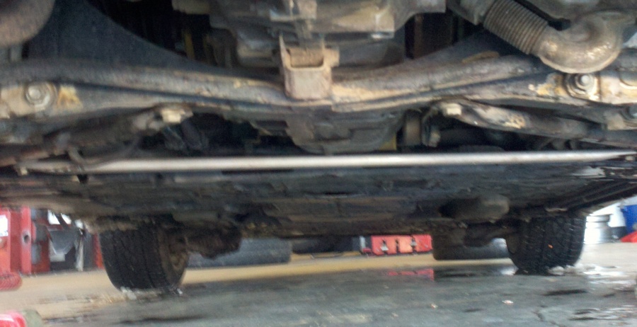

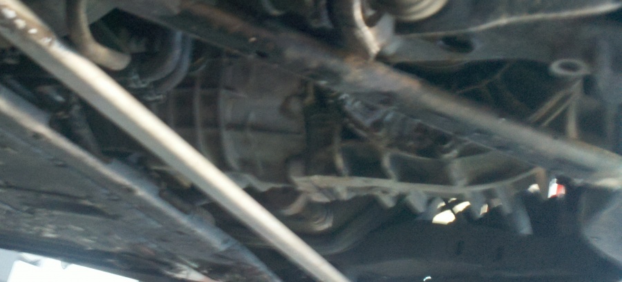

If I take a picture of the underside, is there anything you guys can tell me? It looks pretty sealed up though (i.e- no exposed stuff like my M3). I'm getting the winter tires put on now so it's a great photo op

is there a drive shaft at the front ? look by the tranny, you should be able to see if the drive shaft is connected to the output shaft...
(i think thats what the're called)
what kind of snow tires did you go with ? also, what sizes ?

Old Dec 23, 2011 | 03:04 PM
Ajs76's Avatar
Joined: Nov 2010
Posts: 286
From: Seattle
Ajs76 is infamous around these parts
Alright, so here's some pics I just snapped from the rear. They might be too bad to actually see anything.
It looks like some kind of shaft is going towards the front of the car.
