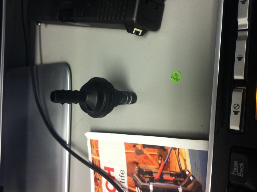

# 16 is the issue... I changed 3 of them in last 2 months...
thats the check valve for that plastic line.. if it's still not holding then there is a built in one inside that plastic line.... you can unclamp it and blow thru it downstream.. if its coming out on the other end its busted.. you need a new $160 line...

The red line drawing is right. #16 is bad. #19 check valve lets the gas tank vent (when solenoid on 14 is open) into the inlet of the turbo On boost. Off boost the check # 16 lets the Gas vapor into plenum post TB.. Keepin it green Yo! Man I would have stay in Europe for new years.

Easy there big cat you got it right. I have the valve sitting on my desk.I can hit the post office tomorrow.

#16 should take care of the issue... I never seen the actual valve on the black plastic hose go bad...

i replaced this check valve when it faild , i installed Mitsubishi Evolution check valve which rated for 40psi , and boost were fast
