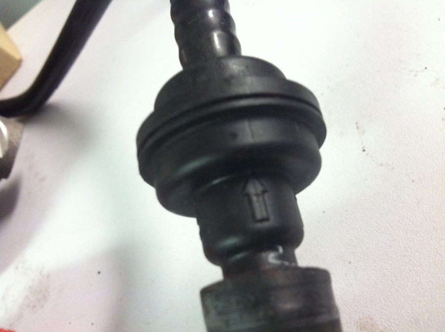

Here is a pic

Yes the arrow on that check valve (19) points to the inlet of the turbo.

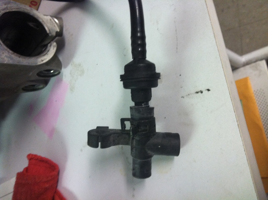

Tim941NYC Is a GOD !Tim941NYC Is a GOD !Tim941NYC Is a GOD !Tim941NYC Is a GOD !Tim941NYC Is a GOD !Tim941NYC Is a GOD !Tim941NYC Is a GOD !Tim941NYC Is a GOD !Tim941NYC Is a GOD !Tim941NYC Is a GOD !Tim941NYC Is a GOD !
here is a clearer pic

So does this hose need to be plugged in order to pressure test then ?, it would seem so, as it is connected to the IPD intake plenum, which is obviously under pressure. Maybe I'm just not testing properly ?
