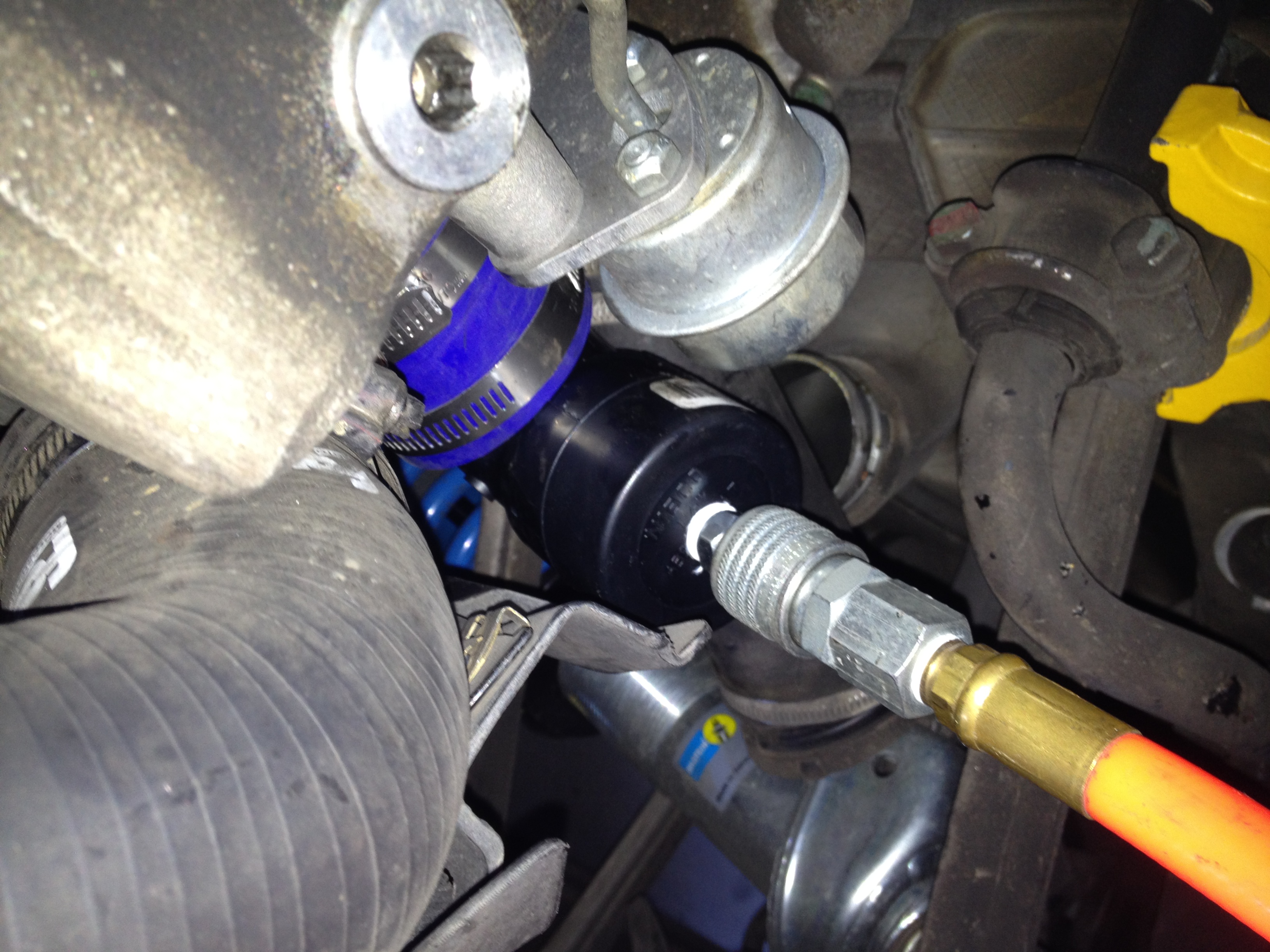

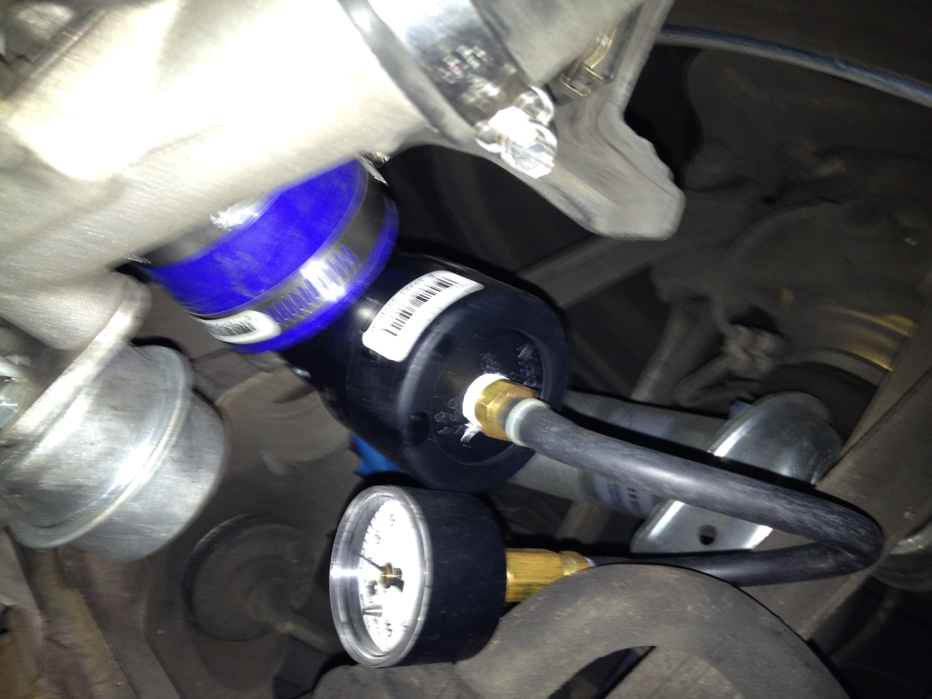

Your doing it wrong
You need a tire valve stem that's a one one check valve. You block one turbo and pressure the other
Go to 20 psi. Disconnect the hose and look for issues.
No wonder why you have been chasing gremlins.

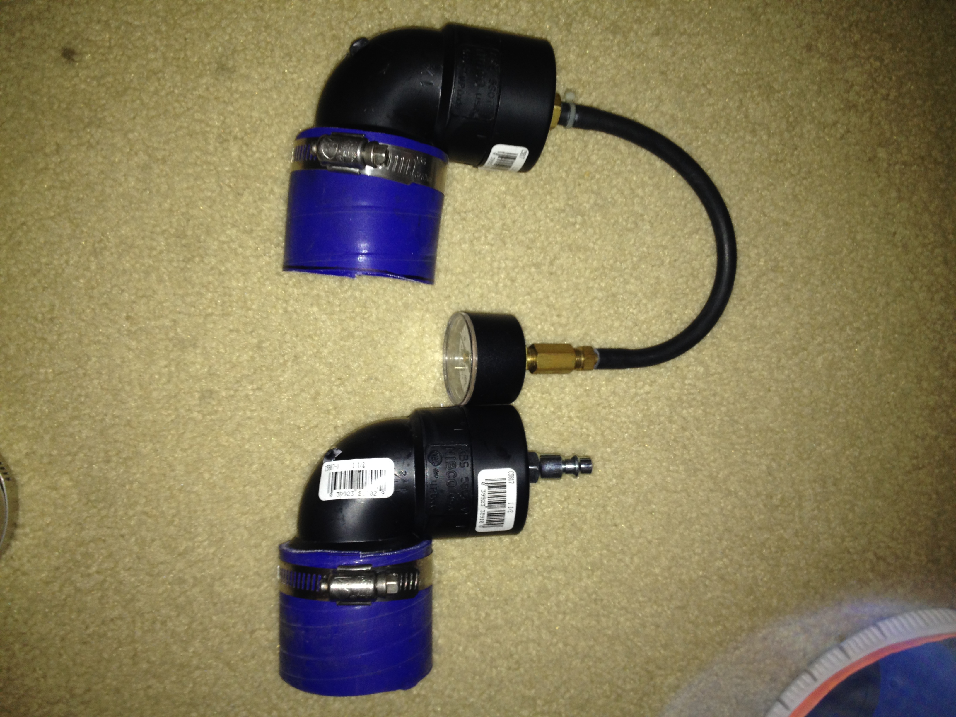

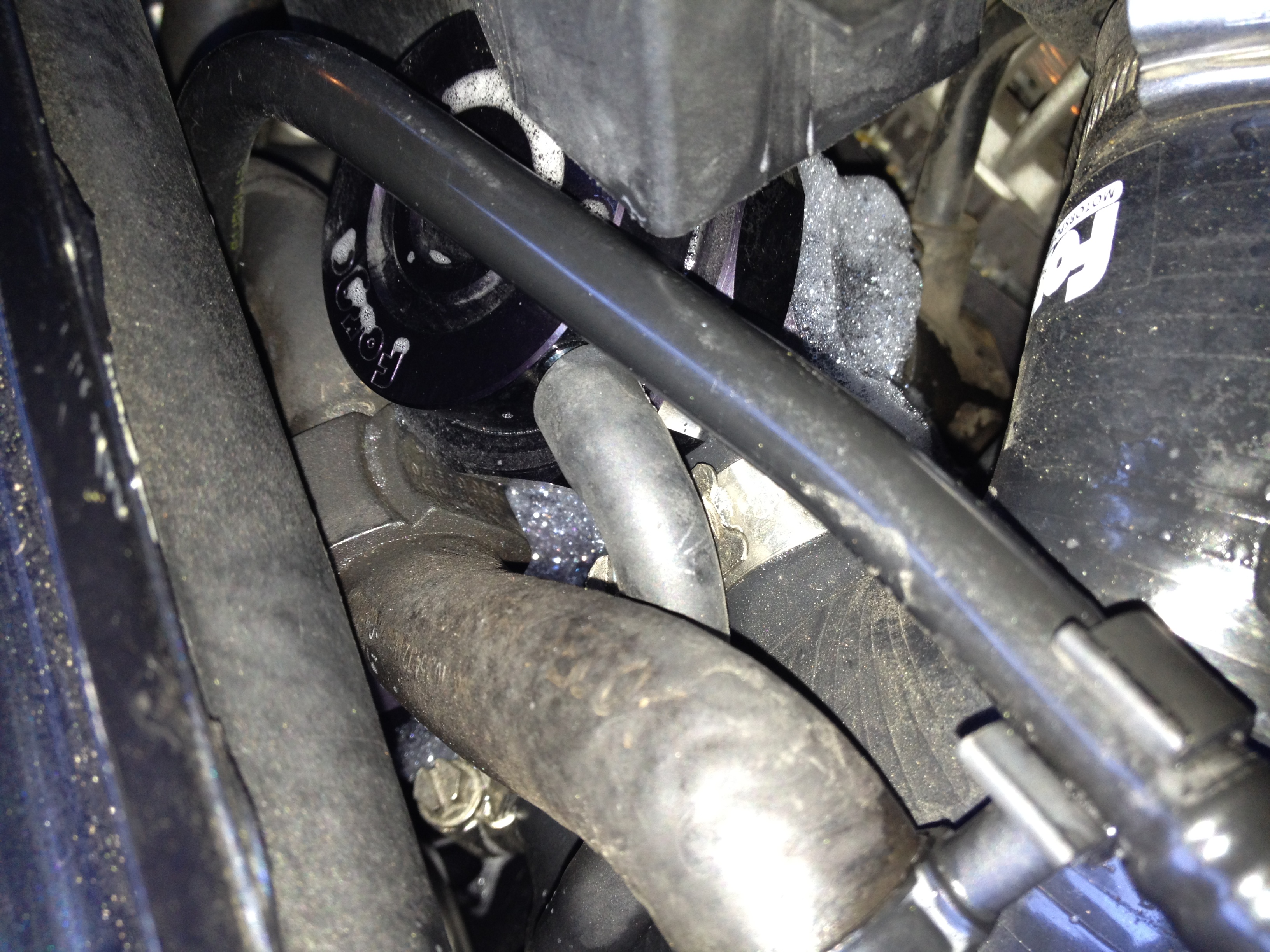

Markski,
Currently I am filling up my twin tank portable air compressor to 140psi. I set the regulator to 20 psi and plug in the hose. I verify the pressure on the other side of the turbo is also reading 20 psi and start looking for leaks.
I have currently found leaks at the DV's and Venturi tube #9.
I am leaking air to the point where even if I unplug the air compressor it will drain the air from the system, hoses, and the air compressor tanks in 3-5 minutes. (didn't time it, so just guessing). I can easily switch over the air compressor hose fitting to a tire pressure valve, but would expect the system will drain the pressure so fast I will not be able to locate the leaks.
I ordered both the #16 check valve and #9 venturi tube.
I am not total convinced #16 is having issues as there was no air bleeding into the #19 tube (so maybe that check valve was working) I am replacing it anyway since I will be in there.
What I am trying to locate is the line that is loosing air into what I believe is the oil reservoir and intake on the driver side.

not sure you know but you may be creating more problems then you started out with...
most of those valves are rated at 20 psi if that..
how can you finds leaks if you do not close the system off... your doing this wrong period.. if it escapes so fast then yo have a huge problem... you need to find it... but bu blowing constant air into the system is not the right way... you have to turn everything off.. it has to be silent.. you look, listen, spray and find...
I told you what to do but your not listening... put a tire valve stem on it.. put 20 psi and find the issues.. well you found 2... but those are not big leaks...
I suggest doing it form the lower boost hoses.. you will find it faster...
