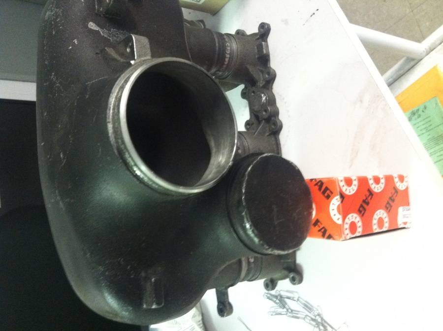

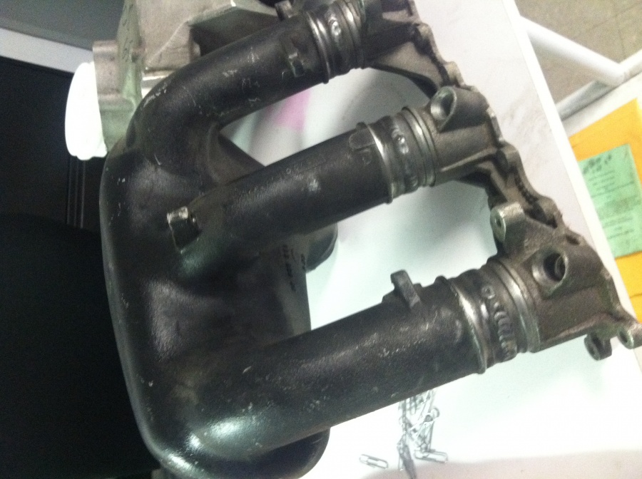

Here are some pics of a intake I used
Wow ...Pretty trick...You must know what you are doing...

The only thing I know I am doing is spending lot of money on a 9 year old car! Guess you picked up something in those pic's
