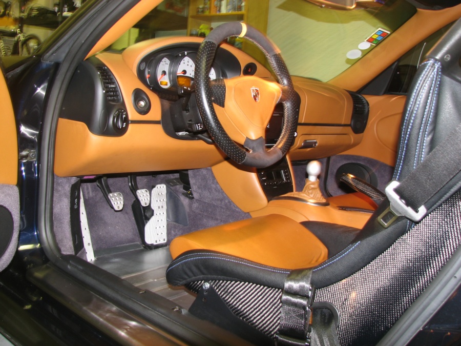

Guys - thanks a lot again; really good material here. The more I think about the more I keep landing on the idea of turning my car into a fully dedicated track. I recently installed a set of KVW3 coilovers and while I really liked them at the track, they do make the ride on the street stiffer. Same is true with the safety gear....specially after watching those videos makes you want to get a full rollcage and everything else that is needed.
Thanks!
