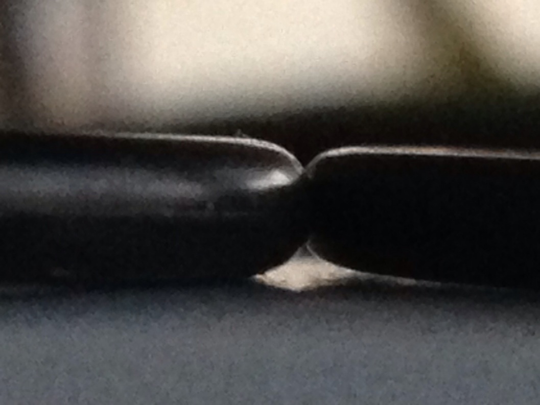

Update on my little coolant leak.
If you look close at picture 4, you can see the coolant is collecting below. Also, take a look at the "O" ring at the right; this is the coolant "O" ring. They are 26mm (ID) and 3mm thick. I had replacements but are not Porsche parts. I have not put anything back and thinking I might stop by the parts department and just get them. I believe this was my area of the coolant leak. I inspected the coolant housing and the hoses that are associated with coolant loop. All looks good. Champion Motorsports, makes aluminum elbows that are bellow picture 4. They attach thru the bottom with a screw and provide the coolant flow to the heat exchangers. They are neat but pricey. I have not dropped my engine yet but might have to if this does not fix it.

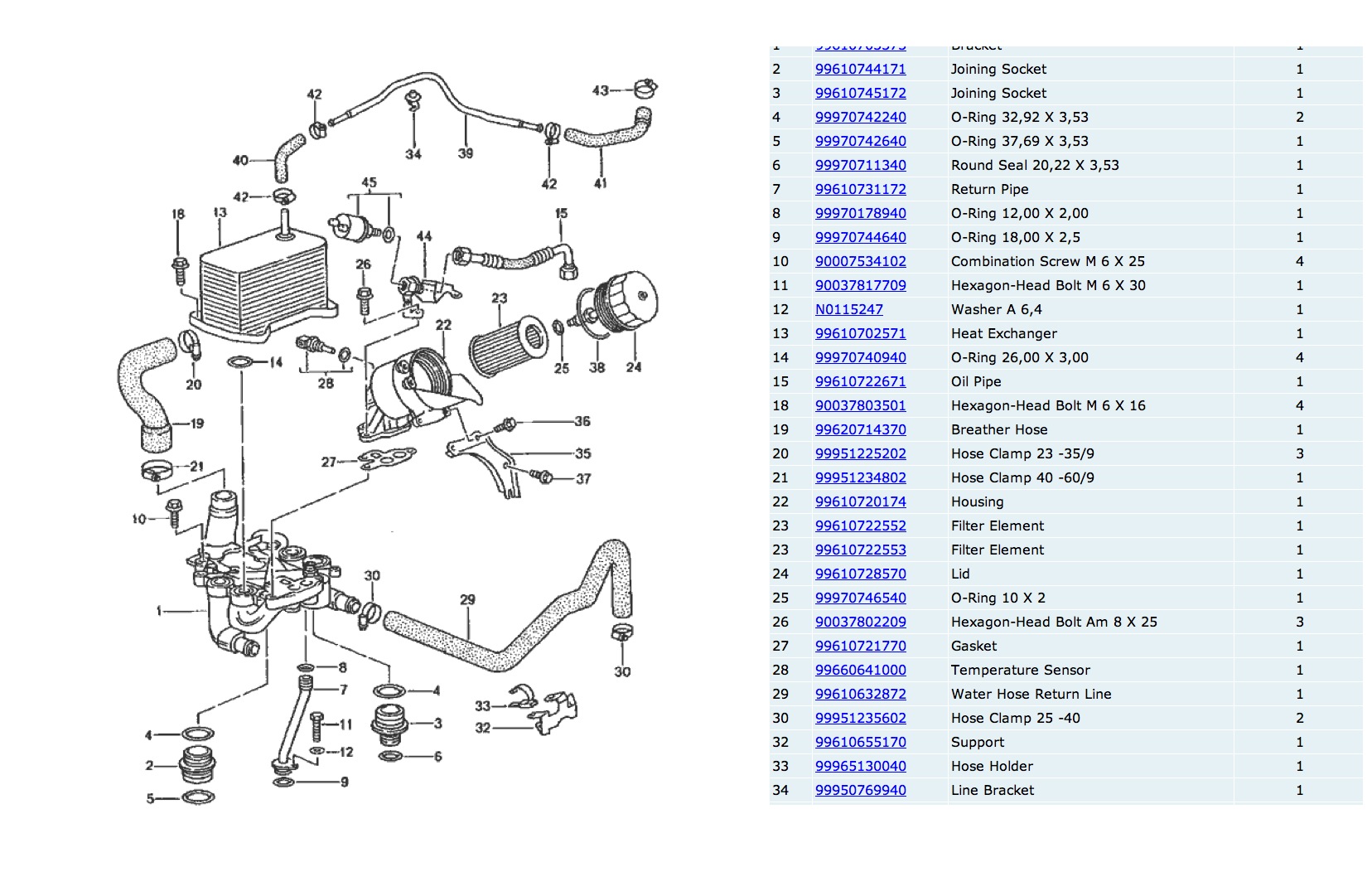

I've installed the Porsche part which are #14 in the parts cat picture part#99970740940. They are 26 x 3 and agree with you, you want to rebuild this portion properly because it is really deep and hidden behind lots of components and lines…. Good job so far!!!!

Nailed it! No more leaks! I can't beleive four little O rings caused me so much headache. Ran the car very hard and it seems to be ok. When I would do that before I would smell both coolant and see it. Thanks to all whom helped and I hope my experience will let everyone see that working on these cars is not difficult. This could have turned into a very expensive repair. Dealerships will do anything to scare and convince that you have a serious problem.
