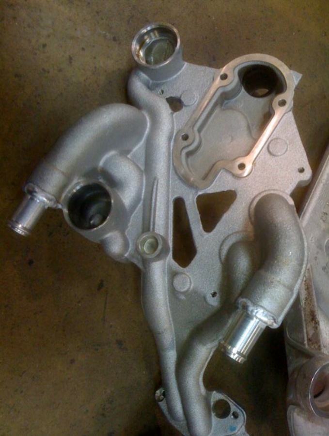

Some of us will do this repair. I would like to be able to order all the parts needed before starting the job. You know how it is to wait for 2 to 3 weeks to get parts you didn't know it was necessary....Please if you see something missing let me know and I will add it to the list. Thanks for your help.... Also if there are any parts needed for the engine removal/installation, please let me know....
There is a total of 8 pipes to weld (6 straight and 2 curved). See Mad Ness post #20: https://www.6speedonline.com/forums/...p-motor-2.html Thanks Mad Ness and smdubovsky for the info and pictures....

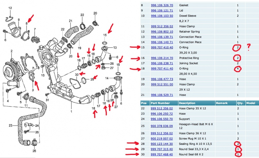

Second , the water pump housing: 3 pipes.
Parts needed: Item#3: 996 106 340 71 X 1 (if needed due heat application)
item#8: 996 106 326 70 X 1 (if needed due heat application)
item#15: 999 707 410 40 X 2 if needed....
item#16: 996 106 214 70 X 2 (if they are elongated)
item#18: 999 707 411 40 X 4
item#29: 999 707 315 40 X 1
item#30: 999 707 468 40 X 1 only if you remove the turbo pumps
item#28: 900 123 144 30 X 2 Coolant drains.

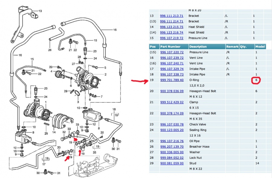

Added: turbos supply and return lines 6 o-rings:
item# 19: 999 701 789 40 X 6

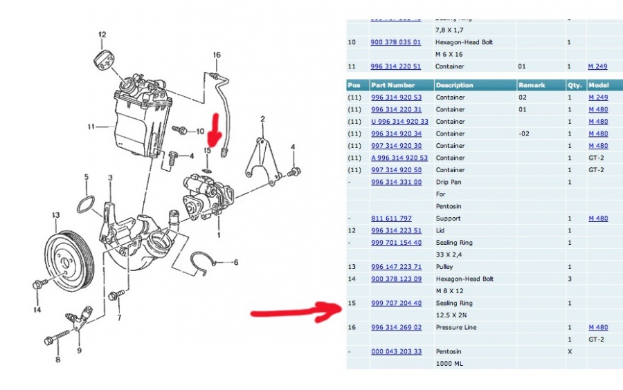

Another one to do as mention by And996tt, thanks!
Finally one pipe on the steering pump bracket (curved)
Part needed : item # 5: 999 707 298 40 X 1
item# 15: 999 707 204 40 X 1 seal between reservoir and steering pump
Also the seal between the steering pump and the reservoir if removed:
