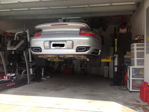

I know some people have used epoxy glue for the anchors. I also had one of my Wej-it becoming flush with the floor but I realized the inside of the column needed shims because the floor was uneven due to the drain being in the center of the garage... . After shimming everything was stable….
My install went well other than the anchors setting in slowly. I followed the instructions to the T. After a few lifts the anchors finally settled. See picture. Still affraid to get under the car

Very good job Al!!!!Don't worry , it took me over a year before I was feeling comfortable to work under the car!!!!LOL!
