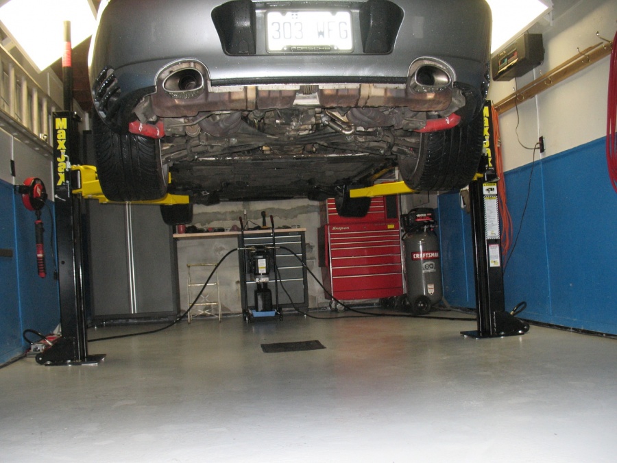

Bloody Hell JP your not hangin arround. 2 questions.
1. Have you got a car hoist? If not how did you get the car up high enough to use your new engine jack and to have enought room to actually drop the engine???
2. Have you left the transmission in the car?

You already got your answer for question # 2 Working too hard may be Frank!!!!
For question #1 , I have installed a Maxjax last summer . I had to redo the floor with the mandatory Fc = 3000psi (Strength of concrete)... In my case we put 5000 psi to be sure I got good anchorage even if I always wear a hard hat
