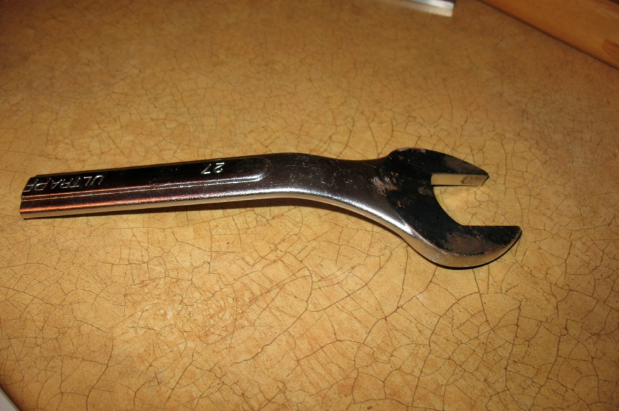

Are you saying you think it is the accumulator? I have the wrench. Just trying to avoid to do the job 2 times. Were my symptoms your symptoms for the accumulator?

I say accumulator. I had the same problem, actually mine never worked, and even passed a PPI from a dealer less than a week before I bought the car with only 14,750 original miles.
Jack up the car, I put jack stands under the rear only and a couple of 2"x8"x12" under each front tire to get them about 3"-3 1/2" up in the air. Disconnect a coolant hose retaining clamp and move the hose up and toward the outside of the car out of the way. Unscrew the old accum. and I had a double plastic bag to put it in handy to catch any oil spilled. I wiped the area with a wet clean rag to make sure no oil was in the area of rubber hoses. Screwed the new one on by hand, wrench tightened. Put coolant hose back in place. Done in less than an hour start to finish. Just about like changing a hard to get to oil filter. The new one will self fill, no need to bleed as a post I read incorrectly states.
Clutch is easy after sitting for days, smoother when driving and no juddery action depressing and releasing as before. Simple to do job. Hardest part was making my wrench tool. I have heard from 2 senior techs at the dealer, that slave may not fail just because accumulators did. Especially with stock clutches. Heavy duty pressure plates tax the slave more and they are more prone to failing.
