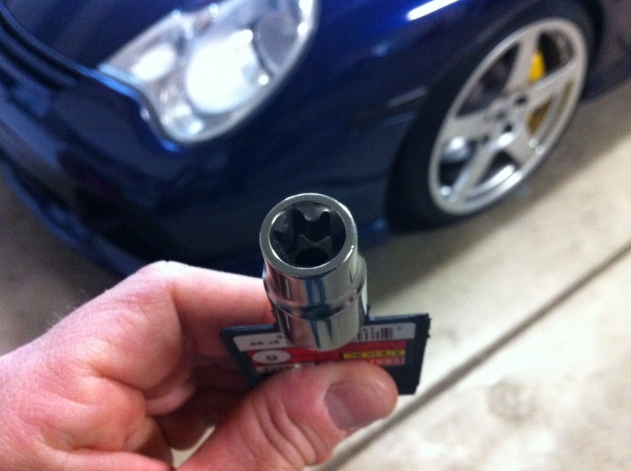

Does anyone know what type of bit is be used to remove the 4 bolts of the seat? I tried a 10mm hex bit but that does not work to loosen the bolts.
You need the E12 torx socket. It is sold by Sears. I had to order it and they shipped it to my house in 3 days.

I found one at my local Ace Hardware
