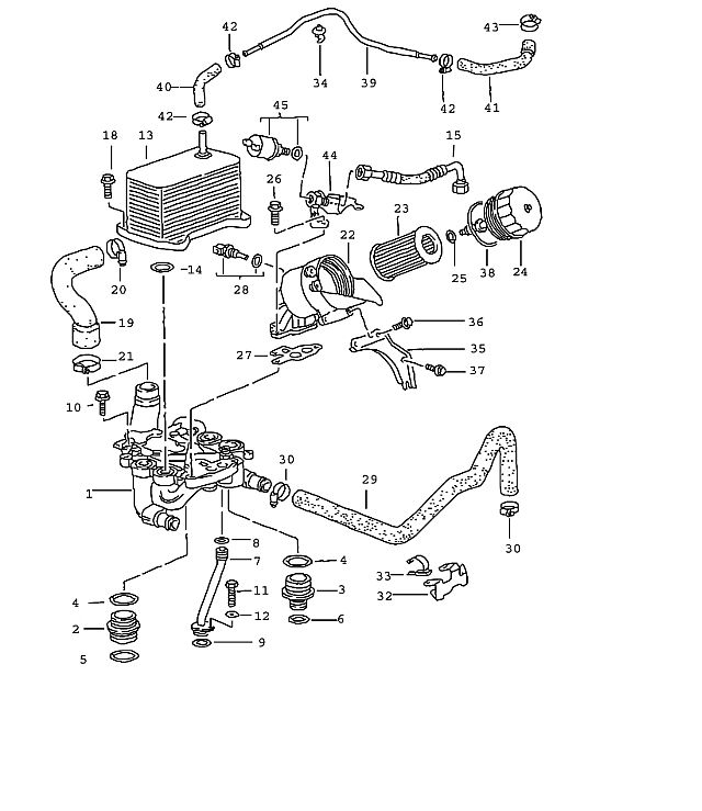

Is this thing a little gold looking canister with two connections on top behind the oil filter. Please say yes...because it looks like a wire popped off. Can I get that lucky?!
Item # 45 (mid top center of the page is the oil sensor)
http://dcauto.gotdns.com/illustration/index/455263631

Problem solved. I managed to get my hand back in there and reconnect the wire. Sure enough a wire had come loose and come off. Problem solved. The gauge looks much more normal now. Thanks guys!! People always say "check the wire" and it never is, this time I got lucky! I'm thrilled.
