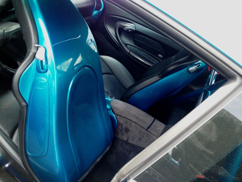

997 GT3 Power seats in a 996 Turbo
I'm new to this forum so I'm not sure if restarting this thread is the correct way to go but its worth a shot. I have a '03 996 Turbo and I would like to upgrade the seats to 997 GT3 Seats. Does anyone know if the power seats will work in a 996? I have seen threads about people installing the 997 seats that have only the power reclining feature but the seats I am thinking of installing are full power. Any info on the subject would be much appreciated. Here a few pics of the seats I'm thinking of installing.

That looks perfect with the matching deviated stitch to pull it all together.
