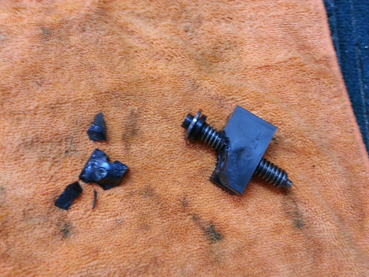

Same symptoms - Spoiler doesn't goes up
I don't know if this happened after a leak or concurrently with a leak.
I followed a collection of posts attempting to bleed and add stop leak, all of which failed. On a test bench with 12V battery, the rams didn't move at all.
I gave up and ordered the fixed wing kit, but since I had all of this kit in hand I decided to take it apart and see what seals are present, how it works, etc.
Much to my dismay I found that there's a large plastic block that's threaded.
The motor turns a threaded rod which moves the plastic block up and down to push the hydraulic pistons up/down in their cylinders.
Upon disassembly I found my plastic block broken into two large pieces with a few smaller sharp shards.
So, the failure is first the broken pump, then possibly a leak and/or problems with lift cylinders.
For $150 I'm making my wing a fixed wing. Screw you Porsche.
