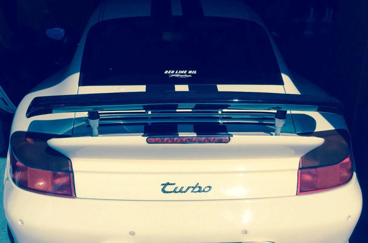

Here is Steve's white '01 turbo and aftermarket wing raised up with his new 4" eRam system.
Dave

2 hours and some Lucas ps stop leak(and a spoiler tool that I already purchased). 👍🏻😎. I pulled the rear spoiler, inserted a small tool in the piston top for pumping inorder to prime the line better. I was alone, and since I had removed the light already, I used the 12v from the hood light to motor the pump pistons to dead low without disconnecting the microswitch. Filled it completely with Lucas. About 3-4 ounces. They extended even and perfect. Although the spoiler fault light still alerted. I pulled the uplimit microswitch, cleaned it, and put it back in. Operation perfection for now. Thanks for the great write up!
Finished product
