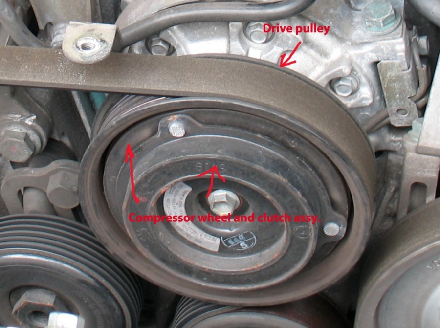

IMHO I don't think any of those codes are related to the a/c problem your having. First thing to do is look at the freon compressor, with the a/c switch "ON",.Can you see the complete wheel assembly turning or only the outside of the wheel on the compressor. Sometimes you can feel the compressor loading with a very small decrease in rpm... Second, when you select the a/c "ON" you should have both of the fans in front starting... If none of those are working a low level of refrigerant is the first thing to looked at. Of course after looking at your fuses E7, C7, D6 !!!
