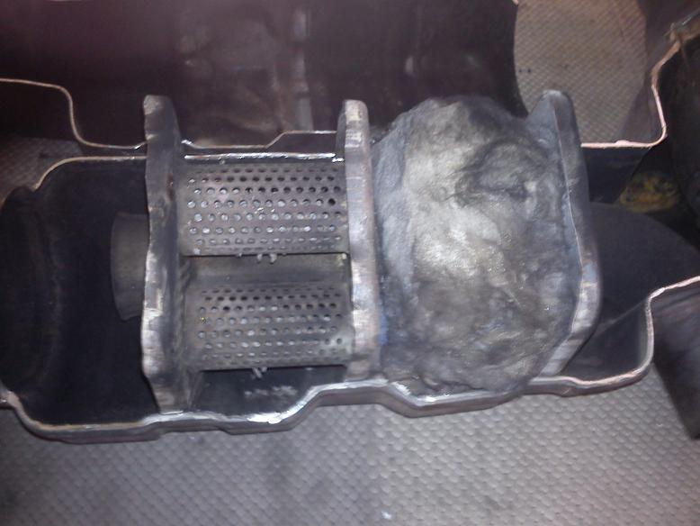

I want to modify my stock exhaust like the RUF. I understand that they remove the stock cats and install a single 100 cell. They also remove a restrictive pipe in the muffler and place a larger one in there, if I am not mistaken. Could someone point out which pipe that is? I have a plasma cutter and a welder and anything else I might need to do this. I'm wondering how I should go about opening up the muffler also.
This is a photo of the drill mod, used this pic for reference.

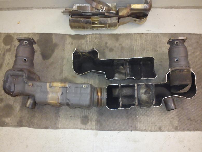

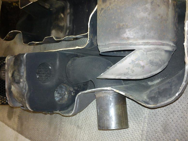

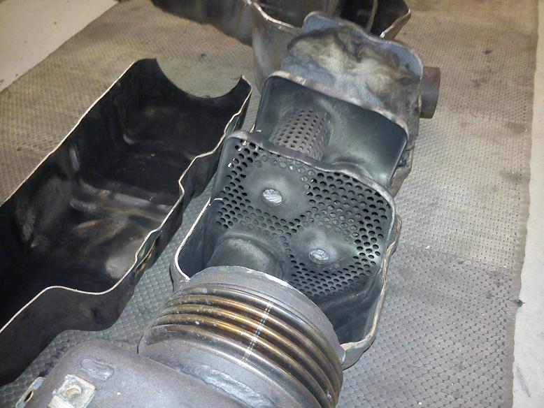

If you want to do a really unrestrictive OEM-look exhaust my suggestion is this:
-cut open the exhaust from the seams. Very thin angle grinder's blade is just fine
-remove pacmen
- either 1 open the ends of perforated muffler pipes OR 2 replace them with one about 2½" perforated pipe
*Option 1 is easy. Option 2 requires the removal of the muffling section, exit pipe must be cut loose. Here the plasma cutter becomes handy. Self-explanatory when you've opened the exhaust.
-replace silencing material
(-replace the primary catalytic converters with 100 cell ones. Will require new tune to solve CELs from secondary lambdas)
-weld the exhaust back together and you're done
If you have the tools and ability to do this the cost is minimal without replacing cats.
I've replaced the cats and have a slightly different solution from advice above...pictures will follow when the exhaust is installed. Hopefully within few weeks.

Just took it off, weighs a million pounds, no chance that I put it back on my car. Gonna build my own exhaust.
