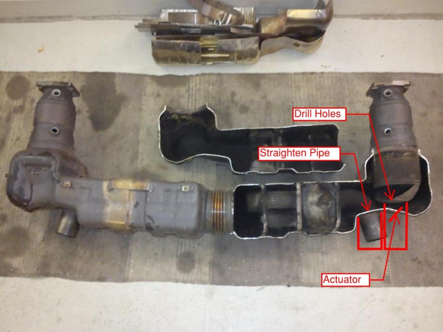

Adjustable Stock Exhaust
I was thinking about trying this. Has this been done before?
....thats looks like a very good way to mod. it..

Hi,
had already done this mod with the "ajustable" valves:
https://www.6speedonline.com/forums/996-turbo-gt2/78446-modified-oem-muffler-996tt-26.html#post3072976
Like you noticed, you have to drill holes in the exhaust guide plate behind the cat. If you dont, you have a severe "drone" between 1.200 and 2.500 U/min.
The third pic of my old post show, (thru the open valve) the air guide plate on the second cat. After drilling holes in that part, the drone was nearly gone.
But mutch better with removed second cat (with the guide plate)!
Reg.
Phil

Originally Posted by phil996tt
Hi,
Reg.
Phil
Where can you get actuators at? Also how did you hook them up?

Does anyone know where to get the actuators from?

Search for Pierburg / Kolbenschmidt Part Nr.: 7.22525.09.0 (60mm Valve)
