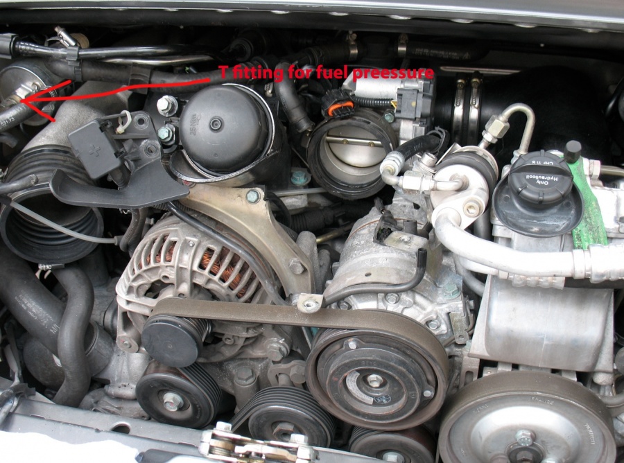

Is it possible for you to check the fuel pressure with a gauge connected next to the fuel filter. The pressure should be 3.8 bars (55 pounds)with the engine not running.... To eliminate the fuel pressure being low due to a broken loop hose on the pump....

The fuel filter is next to thr intake right? so just unplug a hose and connect a pressurd gage?
i am stck with the car in my garage as a tow truck cant get in and most mechanics around dont really know these cars

On the left side. You will see a round aluminum can with a T fitting on it. That is where you can get fuel pressure.
More info here: https://www.6speedonline.com/forums/...sure-test.html

thank u! i will try it tomorrow when i have more light.. Mine looks different though, aftermarker probably
How different does it look? Is is a fuel filter and not a aftermarket fuel pump (044)?
I'll take a pic, it is smaller than the one in the pic and it is red and blue I think.. looks like a fuel pump to me because I had something similar in an old nissan
