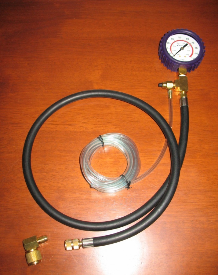

Here's two pictures of the gauge assembly and the adaptor. I don't have a thread gauge but the width is 10mm.... The second hose (transparent) is to relieve the pressure after used. Very useful tool for less than $75.00 with the adaptor....

yea don't relieve that pressure and you will be in for a huge surprise .possible fire
and gas in your eyes
