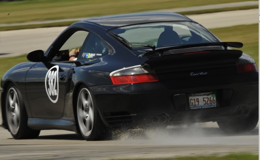

Originally Posted by jpflip
I went to the dealership here in Montreal (Laval) called Lauzon Porsche for parts. While waiting I ask if it was possible to talk to the shop manager. My question to him was , what do you do in a case of coolant lost due to the sleeve popping out? He look at me like if I was from another planet, and his answer was "this is blown out of proportion and I think it is a internet urban legend" and he left.... I am sorry for the people that own a Porsche and get it fix at this dealership or any in Montreal.....
Wow! And I guess that if you showed him this photo from Frank Dorn
(http://forums.rennlist.com/rennforum...the-track.html)
he'd tell you that it was a PhotoShop trick, right?
Jon, I told him I took picture of my own engine with the pipes leaking and completely loose in the recess and he simply turn his back and went to his office. But I have to admit that I had dirty working clothes and had a three days unshaved bear
